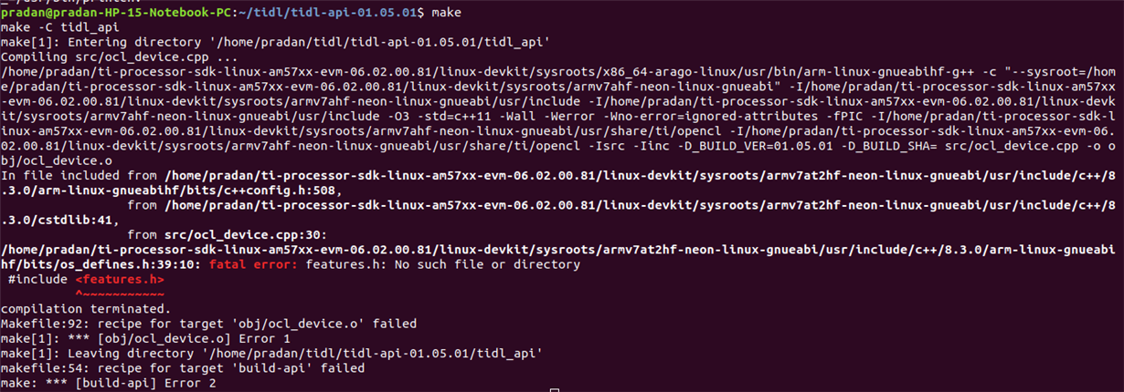

Now, when I try to make all the components of the API using the `makefile` in `tidl/tidl-api01.05.01` directory, I get the error
pradan@pradan-HP-15-Notebook-PC:~/tidl/tidl-api-01.05.01$ make
make -C tidl_api
make[1]: Entering directory '/home/pradan/tidl/tidl-api-01.05.01/tidl_api'
make.inc:99: *** C++ cross-compiler arm-linux-gnueabihf-g++ not found. Set PSDK_LINUX to point to the target Linux PSDK for automatic configuration, set HOST_ROOTDIR to the x86_64 Linux devkit, or add the compiler bin directory to PATH..  Stop.
make[1]: Leaving directory '/home/pradan/tidl/tidl-api-01.05.01/tidl_api'
makefile:54: recipe for target 'build-api' failed
make: *** [build-api] Error 2

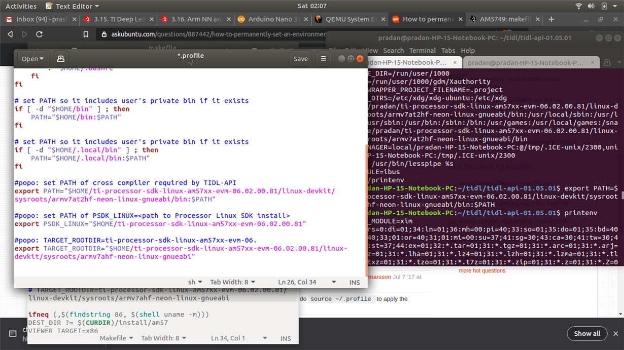

  • Ok so here's the update. I permanently changed my PATH as:
    $ gedit ~/.profile
    And then, I sourced this file using
    $ source ~/.profile
    So, the actual problem got resolved but this is what I face now:
    I tried searching for the "features.h" file in the SDK folder and found many of them... I added the one in "...usr/include" to the environment but still to no good.
    please help

    After this, I again tried installing the TIDL using your suggestio. Here's the persistent error I am facing:
    pradan@pradan-HP-15-Notebook-PC:~/ti-processor-sdk-linux-am57xx-evm-06.02.00.81/tidl$ export PSDK_LINUX="~/ti-processor-sdk-linux-am57xx-evm-06.02.00.81"
    pradan@pradan-HP-15-Notebook-PC:~/ti-processor-sdk-linux-am57xx-evm-06.02.00.81/tidl$ export TARGET_ROOTDIR="~/ti-processor-sdk-linux-am57xx-evm-06.02.00.81/linux-devkit/sysroots/armv7at2hf-neon-linux-gnueabi"
    pradan@pradan-HP-15-Notebook-PC:~/ti-processor-sdk-linux-am57xx-evm-06.02.00.81/tidl$ export HOSR_ROOTDIR="~/ti-processor-sdk-linux-am57xx-evm-06.02.00.81/linux-devkit/sysroots/x86_64-arago-linux"
    pradan@pradan-HP-15-Notebook-PC:~/ti-processor-sdk-linux-am57xx-evm-06.02.00.81/tidl$ make build-api
    make -C tidl_api
    make[1]: Entering directory '/home/pradan/ti-processor-sdk-linux-am57xx-evm-06.02.00.81/tidl/tidl_api'
    Compiling src/ocl_device.cpp ...
    ~/ti-processor-sdk-linux-am57xx-evm-06.02.00.81/linux-devkit/sysroots/x86_64-arago-linux/usr/bin/arm-linux-gnueabihf-g++ -c "--sysroot=~/ti-processor-sdk-linux-am57xx-evm-06.02.00.81/linux-devkit/sysroots/armv7at2hf-neon-linux-gnueabi" -I~/ti-processor-sdk-linux-am57xx-evm-06.02.00.81/linux-devkit/sysroots/armv7at2hf-neon-linux-gnueabi/usr/include -I~/ti-processor-sdk-linux-am57xx-evm-06.02.00.81/linux-devkit/sysroots/armv7at2hf-neon-linux-gnueabi/usr/include -O3 -std=c++11 -Wall -Werror -Wno-error=ignored-attributes -fPIC -I~/ti-processor-sdk-linux-am57xx-evm-06.02.00.81/linux-devkit/sysroots/armv7at2hf-neon-linux-gnueabi/usr/share/ti/opencl -I~/ti-processor-sdk-linux-am57xx-evm-06.02.00.81/linux-devkit/sysroots/armv7at2hf-neon-linux-gnueabi/usr/share/ti/opencl -Isrc -Iinc -D_BUILD_VER=01.05.01 -D_BUILD_SHA=4b801ad src/ocl_device.cpp -o obj/ocl_device.o
    In file included from /home/pradan/ti-processor-sdk-linux-am57xx-evm-06.02.00.81/linux-devkit/sysroots/armv7at2hf-neon-linux-gnueabi/usr/include/c++/8.3.0/arm-linux-gnueabihf/bits/c++config.h:508,
                     from /home/pradan/ti-processor-sdk-linux-am57xx-evm-06.02.00.81/linux-devkit/sysroots/armv7at2hf-neon-linux-gnueabi/usr/include/c++/8.3.0/cstdlib:41,
                     from src/ocl_device.cpp:30:
    /home/pradan/ti-processor-sdk-linux-am57xx-evm-06.02.00.81/linux-devkit/sysroots/armv7at2hf-neon-linux-gnueabi/usr/include/c++/8.3.0/arm-linux-gnueabihf/bits/os_defines.h:39:10: fatal error: features.h: No such file or directory
     #include <features.h>
    compilation terminated.
    Makefile:92: recipe for target 'obj/ocl_device.o' failed
    make[1]: *** [obj/ocl_device.o] Error 1
    make[1]: Leaving directory '/home/pradan/ti-processor-sdk-linux-am57xx-eppradan@pradan-HP-15-Notebook-PC:~/ti-processor-sdk-linux-am57xx-evm-06.02.00.81/tidl$
    What am I doing wrong ?

  • Hey Paula, your answer worked but only after the environment script was sourced `
    pradan@pradan-HP-15-Notebook-PC:~/ti-processor-sdk-linux-am57xx-evm-06.02.00.81$ source linux-devkit/environment-setup
    Thank you for the efforts.
