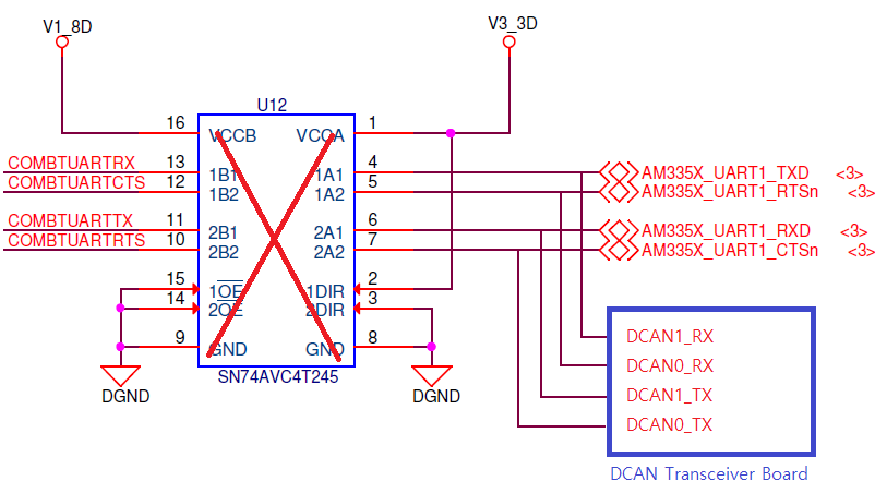

    What you are trying to enable is not supported on the EVM-SK platform by TI since this requires board modifications. The UART1 that you are using to attach to a CAN device is in use with the wifi module on the board for bluetooth support. To connect to a CAN device there will require a line termination circuit to make sure the electrical signals are correct and balanced. You might consider using the expansion headers on a Beagle Bone Black to see if this might meet your needs, again you will need to bread board a line termination circuit.
    The other issue would be the pin mux entries in the DTS file has the incorrect modes for the DCAN interface, these need to be mode 2 for both, not 0.

    2. The hardware has been modified as follows.
    2-1. U12 IC removed.
    2-2. The CAN Transceiver Board with line termination circuit is connected as shown below.

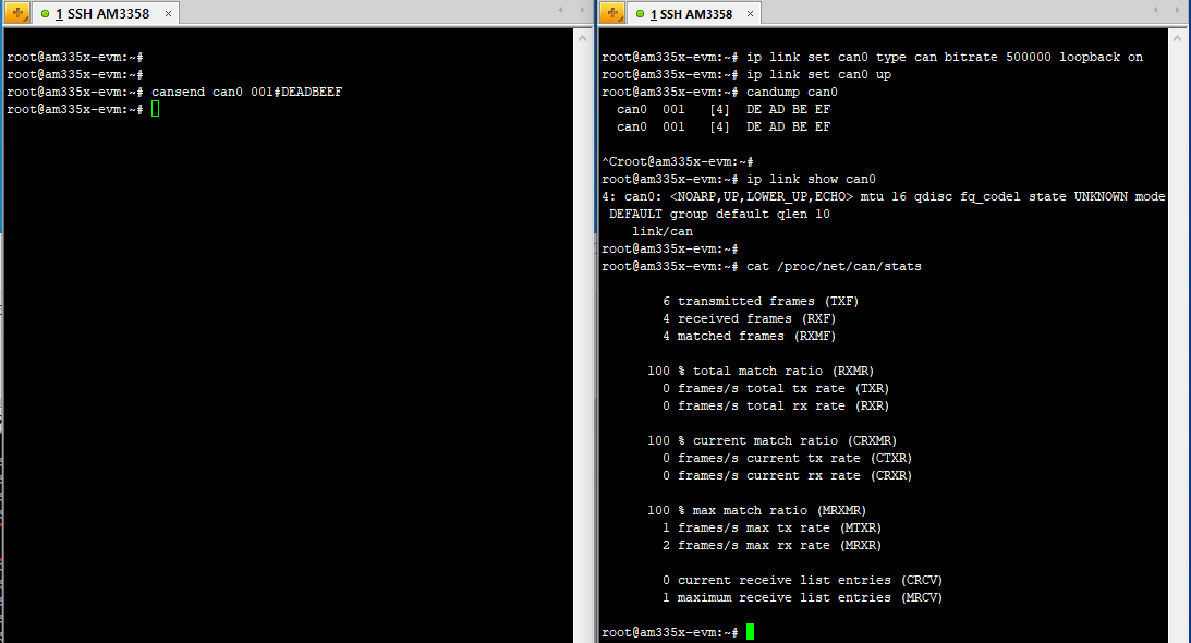

    5. loopback test
    5.1 Initialize CAN Bus (loopback)
    root@am335x-evm:~# ip link set can0 type can bitrate 500000 loopback on
    5.2 Start CAN Bus
    root@am335x-evm:~# ip link set can0 up
    5.3 cansend ( Another terminal )
    root@am335x-evm:~# cansend can0 001#DEADBEEF
    5.4 candump
    root@am335x-evm:~# candump can0
      can0  001  [4]  DE AD BE EF
    Q1. Is there anything else I need to do to activate CAN?
    Q2. How to check if CAN is activated normally?
        Is it possible to check with loopback test?
    Q3. When checking the received message with candump during loopback test, a duplicate message is received.
        Is this normal?
    Simon

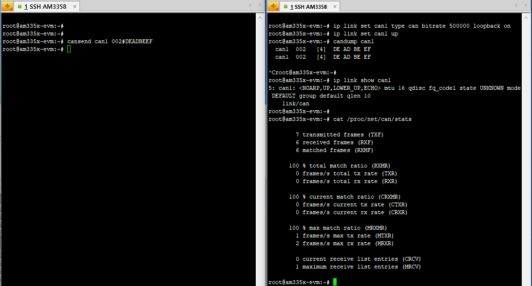

    root@am335x-evm:~# ip link set can1 type can bitrate 500000 loopback on
    root@am335x-evm:~# ip link set can1 up
    root@am335x-evm:~# candump can1
    can1 002 [4] DE AD BE EF
    However, there are still duplicate messages when loopback test.
    Is there anything else I need to check?
    Simon

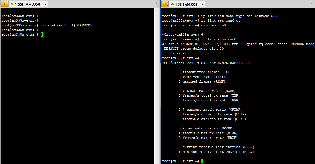

    To confirm, you are connecting can0 to can1 with wires? If so have you tried it without the loopback option being set on the ip command? Could you also show the cansend line and the candump line together? Is the cansend the same as in first post?
    Please post the results of these lines as well.
    ip link show can1
    cat /proc/net/can/stats
    Schuyler
  • Dear. Schuyler
    Please check the following answers to your questions.
    A1. The actual test circuit configuration is connected as follows.
        can0 and can1 are not wired together.
    A2. Here is the result of retesting:
      If I test it without loopback, there is no response from candump.
      1. can0 no loopback test
    2. can1 no loopback test
    3. can0 loopback test
    4. can1 loopback test
    Simon

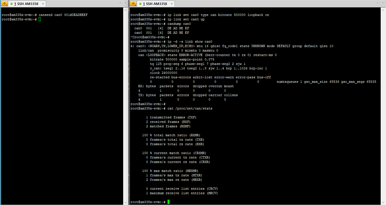

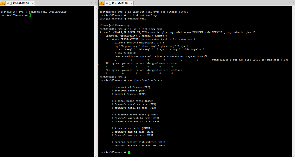

    I apologize for the delay. Could you run the following command ip command with these options, the state of the bus needs to be looked at.
    ip -d -s link show can0
    What is needed is a scope to show the data transmitted the bus. Do you have a scope that could be to look at the traffic on the CANBUS?
    You mentioned that can0 and can1 are connected to each other is this correct still? In the non loopback mode when the stats are being read there is not any RX frames on the can0 interface. Where are the expected frames coming from?

    2. Circuit composition.

    4. can0 TEST ( ip -d -s link show can0 )
        conditions : Point_1 and Point_2 are open.
    5. can0 Loopback TEST ( ip -d -s link show can0 )
    Q1. Is the DCAN driver installed normally?
    Q2. Is the method I tested correct? Or can you tell me the exact test method?
