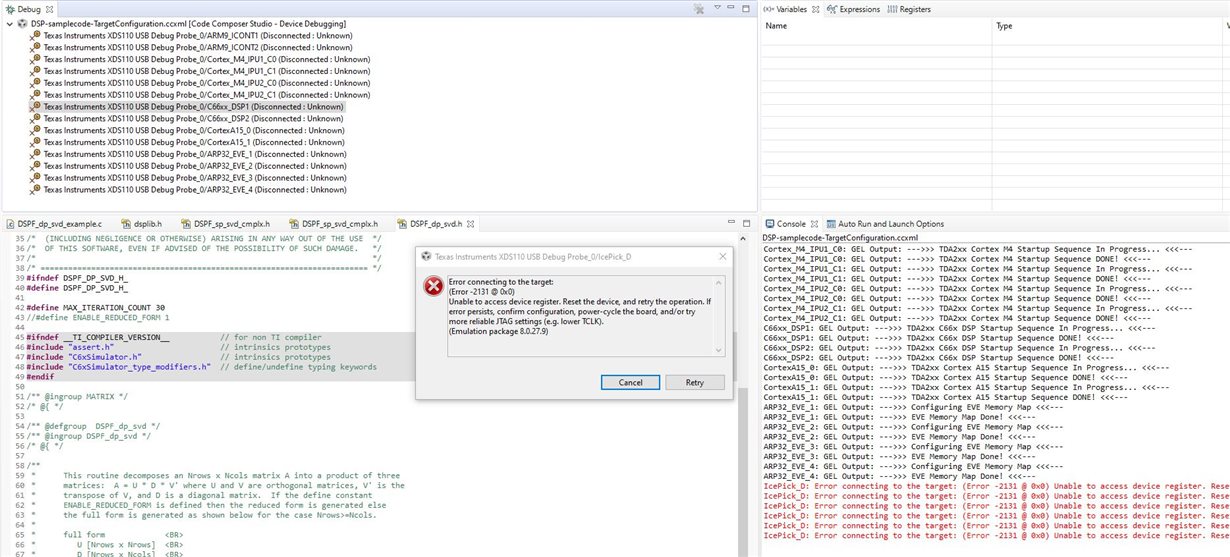

    I skipped the connection test and launched the Target Configuration file. It went further. But when I tried to connect to the DSP1 (right click->Connect Target), I got the attached failure.
    --Khai

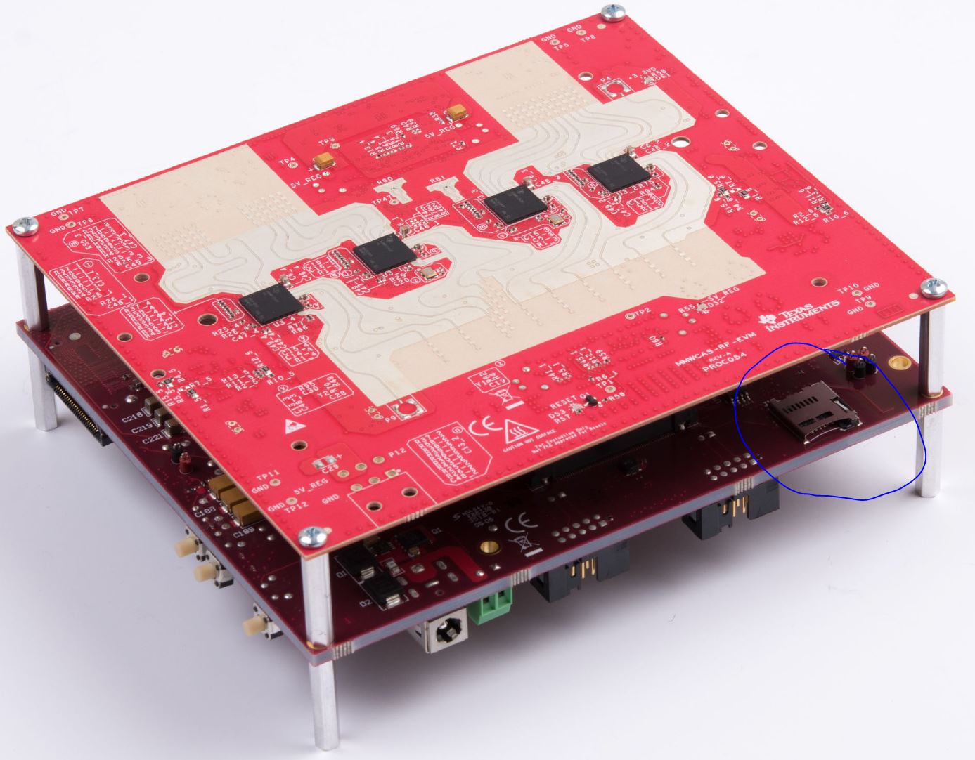

    Wait, I know it says EVM, but I don't see a SIM slot depicted in the general EVM documentation. Is this a custom board you are using? If so could be a problem with JTAG schematics. Another way is to play with the DIP switch to try different boot modes.
    thanks,
    Alex
  • Hi Alex,
    Yes this is the factory TDA2 EVM Processor Board.
    See attached pic.
  • OK this still looks like a HW issues to me. Assuming your JTAG is tested good with other boards, can you give us the EVM serial numbers and we will check with the manufacturer.

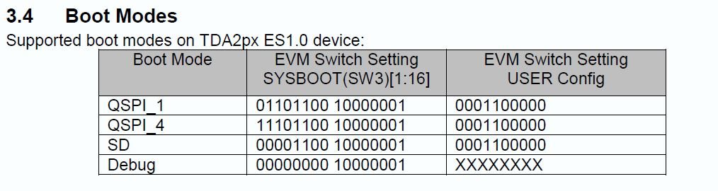

  • SO i found the doc that given to me by Alex that described SYSBOOT in 31.2.4 Sysboot Configuration.
    So looks like there are two main booting type - Peripheral or MEM booting. I assume I need it to be in Peripheral mode. But then how to set the board to be in USB booting mode? Is there a dip switch taken out to the board level to set this boot mode?
    --Khai
  • Hello Khai,
    Apologize if we've been vague, but we also expect the from the user to be familiar with documentation first. When we post a reply, we assume that's already been done and they have read the docs (at least the important stuff like booting the device (like I said found in the initialization chapter in the technical reference manual)). We cannot possibly describe all things documentation explains here. So, you should be familiar and know where to look for information first before asking a question here. For example, get to know the SDK docs (found in the docs folder of the SDK for the device), and TRM (Technical reference manual) and DM (Data Manul) found on ti.com product page (for your processor: https://www.ti.com/product/TDA2P-ACD/technicaldocuments). On that product page, there are also many other custom docs for specific topics that may be needed one time or another.
    Now on to the last question. What we suggest is to set your pins in debug mode and see if you can finally connect. Here is an excerpt from VisionSDK_UserGuide_TDA2px.pdf found in "VisionSDK\vision_sdk\docs\UserGuides" folder.
    Let us know the results please, thanks!
