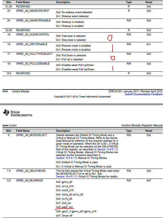

  • Can you please check if you have setup pinmux correctly?
    Rgds,
    Brijesh
  • Thans your reply
    I set the pinmux use HW_WR_REG32, and searched for TRM.
    Is the setting correct?
    HW_WR_REG32(0x4A003440,0x00050008);// uart5_rxd Pinmux
    HW_WR_REG32(0x4A003444,0x00010008);// uart5_txd Pinmux

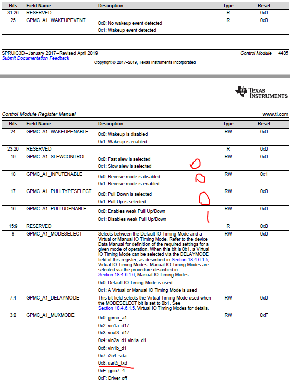

  • Hi, Did not receive your reply.
    Supplementary explanation , I have confirmed that PRCM is turned on, PINMUX is correct, and CROSSBAR is set.
    But when I call uart0Read there is no response from the task.
    Add the UART5 crossbar map  in the Bsp_platformTda2xxXbarConfig
     /* XBAR UART5_IRQ to IPU1_59 */
        BspOsal_irqXbarConnect(CSL_XBAR_INST_IPU1_IRQ_59, CSL_XBAR_UART5_IRQ); //Add by Tim
    Use the  PMHALModuleModeSet API to open the UART5 module
    //Uart 5 CLKCTRL
    PMHALModuleModeSet(PMHAL_PRCM_MOD_UART5,
    PMHAL_PRCM_MODULE_MODE_ENABLED,
    PM_TIMEOUT_INFINITE);
    The pinmux code :
    /* Set the pin Mux */
            Bsp_platformSetPinmuxRegs((UInt32) 8U, (UInt32) CTRL_CORE_PAD_GPMC_A0,
            BSP_PLATFORM_IOPAD_CFG_INPUTENABLE_OUT |
            BSP_PLATFORM_IOPAD_CFG_PULLUDENABLE_ENABLE |
            BSP_PLATFORM_IOPAD_CFG_PULLTYPESELECT_UP);
            Bsp_platformSetPinmuxRegs((UInt32) 8U, (UInt32) CTRL_CORE_PAD_GPMC_A1,
            BSP_PLATFORM_IOPAD_CFG_INPUTENABLE_BI |
            BSP_PLATFORM_IOPAD_CFG_PULLUDENABLE_DISABLE |
            BSP_PLATFORM_IOPAD_CFG_PULLTYPESELECT_DOWN);

    The Uart UT provides testing of the UART5 in Tx mode on the EVM.
    For module enable and interrupt crossbar configuration you can refer the function "st_uartEnableUartModule" in below file
    <pdk_install_dir>\packages\ti\drv\bsp_lld\uart\unit_test\uartUt\testLib\st_uartPlatform.c
    Also you need to check your board schematics the gps signals are coming on which pad of the Soc to capture from UART5.
    Configure the pad configuration corresponding to those pads for mux mode of UART5.
