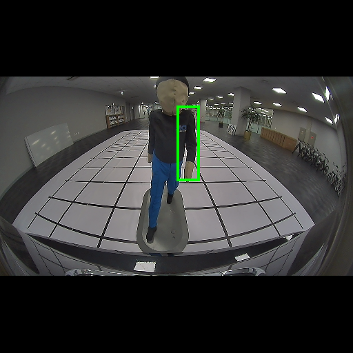

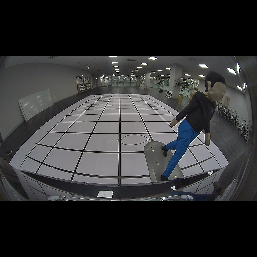

I had replaced the mmalib_01_00_00_00 with mmalib_01_01_00_02.Made Changes in config.mk in tidl/makerules and psdkra_tools.mk in tiovx. Whole sdk clean build done.
1.Is the process right?.
2.If so, I had tried  both configurations with numParamBits and numFeatureBits both set to 8 and 16.
In numParamBits and numFeatureBits set to 8 configuration ,observed misses and false detection in few frames which was not observed in the previous release.
a.
b)

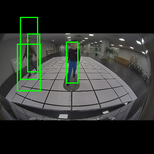

3.With NumParamBits and NumFeatureBits set to 16,observed multiple bounding boxes and misses.
a)
