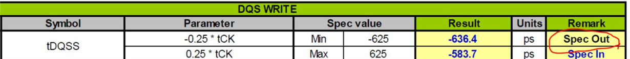

My customer has used AM3352 in their product and recently found DDR test fail in below.
They want to check if this failed value can be acceptable to AM3352 or not.
Could you please confirm below values exceed JEDEC spec are acceptable to AM3352?

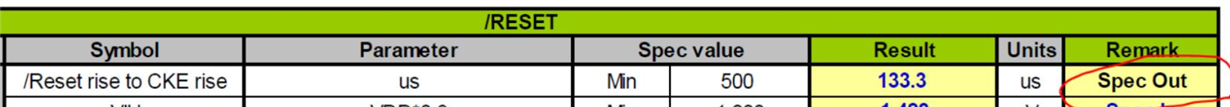

    BTW, is it possible to estimate how impact this failure on AM3352? Do you think this is critical?
    Actually my customer is concerning about the test fail of '/Reset rise to CKE rise'. They can accept 'tDQSS' test fail as they can assume it is measurement error.
    Could you please let me know your opinion how the '/Reset rise to CKE rise' is critical to AM3352?

  • HI SI, I think the reset to CKE violation could potentially cause a boot failure, as you are not giving enough time for the reset to propagate through the memory.
    I checked the SPL code, and i think this is actually easily fixed with the following code change in  arch/arm/mach-omap2/am33xx/ddr.c
    if (regs->zq_config) {
    writel(0x00003100, &emif_reg[nr]->emif_sdram_ref_ctrl);  /*add this line*/
    writel(regs->zq_config, &emif_reg[nr]->emif_zq_config);
    writel(regs->sdram_config, &cstat->secure_emif_sdram_config);
    writel(regs->sdram_config, &emif_reg[nr]->emif_sdram_config);
        /* Trigger initialization */
        /*writel(0x00003100, &emif_reg[nr]->emif_sdram_ref_ctrl);*/  /*comment out this line*/
        /* Wait 1ms because of L3 timeout error */
        udelay(1000);
        /* Write proper sdram_ref_cref_ctrl value */
        writel(regs->ref_ctrl, &emif_reg[nr]->emif_sdram_ref_ctrl);
        writel(regs->ref_ctrl, &emif_reg[nr]->emif_sdram_ref_ctrl_shdw);
    This should give the proper reset timing for the EMIF initialization, which is kicked off by the write to emif_sdram_config.

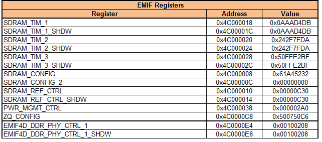

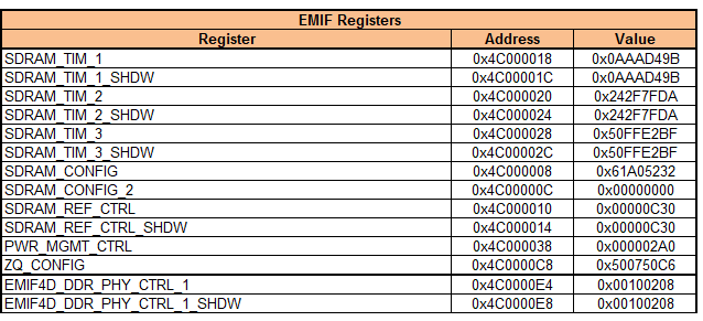

    I tried to calculated EMIF values using latest application notes(sprack4.pdf), and found there were difference in the EMIF timing values, but there was no difference in the EMIF_SDREF value.(both are '0x0000 0C30')
    So, I'm afraid there was no difference in '/Reset rise to CKE rise' even when we modified timing values of EMIF.
    The DDR3 memory is K4B1G1646I-BCMA in below.
    https://www.samsung.com/semiconductor/global.semi/file/resource/2017/11/DS_K4B1G1646I-BC_Rev1_1-0.pdf
    I got the new value as below

  • SI, the usage of reg_refresh_rate in the  ref_ctrl register  is described in section 7.3.3.6.2 in the TRM.  It serves double duty, first to specify the delay time between reset and CKE during initialization, then to specifiy the actual refresh time during normal operation.  The change i made above (which is in lines 166-179 of the ddr.c file you sent) ensures the first criteria, which specifies the 500us delay needed.  After the initialization is kicked offnwith the write to sdram_config (line 169), there is another write in the code which sets reg_refresh_rate to the refresh rate for normal operation (0xC30)
    Please try this change to see if the test passes for that parameter
    James
  • Hi James,
    Thanks to your modification in ddr.c, it seemed it was improved in '/Reset rise to CKE rise'.
    Now they want to focus on 'tDQSS' timing as the max value is -583.7.
    I re-calculated EMIFs using latest app.note you mentioned, but they could not find any improvement when they checked it using oscilloscope with differential probe and they are doubting if it will be improved in the real test.
    May I ask your opinion if it is reasonable to understand there is no improvement based on oscilloscope measurement or should they do SI integrity test?
    As you see, the time interval between 'a' and 'b' is almost same - 520ps.

    The calculated new EMIF values using new  are
    Thanks and Best Regards,

  • SI, it is the PHY registers that are important here.  Can you ensure that you are also using the updated PHY register settings in the code?
    If you look at the uboot tab in the spreadsheet, it will show which structures need to be updated based on the inputs to the spreadsheet.  Please post both the old and new structures so I can help compare.  And ensure the new structures are used in the call to config_ddr()
    REgards,
    James

    After this change in the ddr.c, they found the 'Reset to CKE' timing was changed to '532us' from '132us' in their oscilloscope shot.
    Their QA team now requested to check if there is side effect can be expected in this code change, and I think there should be no issue based on your explanation in the above, but I would like to check with you.
    Please let me know you opinion on this.
    SI.
  • SI, there should be no side effect, this is just a one time setting to ensure the correct Reset to CKE timing.  They just need to make sure that during normal operation, the SDRAM_REF_CTRL = 0xC30.  Based on the code they showed, this should be the case, but they should double check. This will ensure the same operation as before the change.
    REgards,

    Thanks for your response, and tDQSS timing issue was also resolved after applying new PHY values.
