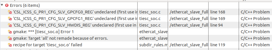

I'm trying to build the ethercat slave inside my ubuntu VM and i'm getting a few errors about undeclared variables that I dont know how to resolve.
I check against my windows build environment. it has these sames variables defined in the same places but the windows build doesn't complain about these variables.
How do I get this to build in linux?

  • Hi Garrett,
    I am using CCS9.1 with processor sdk rtos am65xx 6.1.0.8 and trying to build PRU ICSS EtherCAT Slave 1.0.7.2.
  • Steven,
    Please use the sdk version 5.1 as noted here -
    We will be releasing a new EtherCAT package in a week, which is compatible with sdk v6.x
    Garrett
  • Hi Garrett,
    Thanks for getting back to me. I eventually fixed out I have to use SDK5.

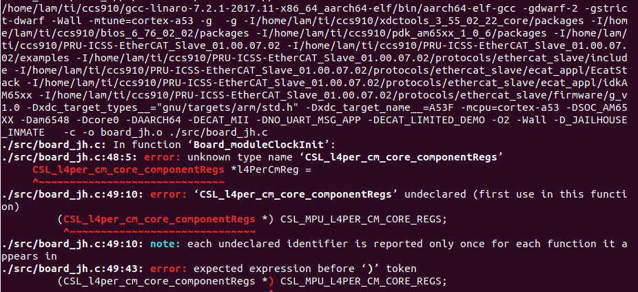

    Do you happen to know how to get ethercat slave to work with jailhouse on AM65?
  • Steven,
    We don't have etherCAT ported to AM65x with Jailhouse. It's only available on AM57x.
    Garrett
  • Hi Garrett,
    On this other E2E post, Dave Bell seems to indicate that it is possible to get EtherCAT jailhouse working for AM65.
    I have modified the EtherCAT jailhouse AM57 makefile to suit AM65.
    Now I'm stuck at the board_jh.c file, not sure what to change to initialize the clock.
