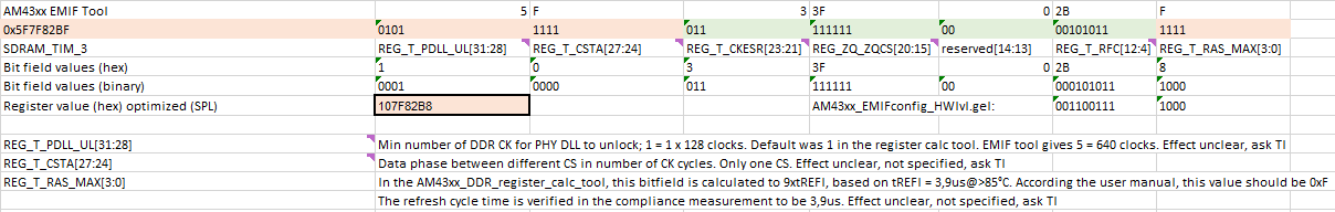

    1) SDRAM_TIM_3:
    Value from EMIF Tool was 0x5F7F82BF and our current value is 0x107F82B8, which meets the value from AM43xx_EMIFconfig_HWlvl.gel as well. The differences are marked in red, so there are deviations in PHY DLL unlock time (0x1 vs. 0x5). The phase differnce between different CS i don't understand (0x0 vs. 0xF), because i specified a single rank 16Bit interface in the EMIF Tool, so only CS0 is used. For T_RAS_MAX, the value should be 0xF according to the user manual and the EMIF_Tool, but the value from the former calc tool was 0x8, same as in the AM43xx_EMIFconfig_HWlvl.gel.

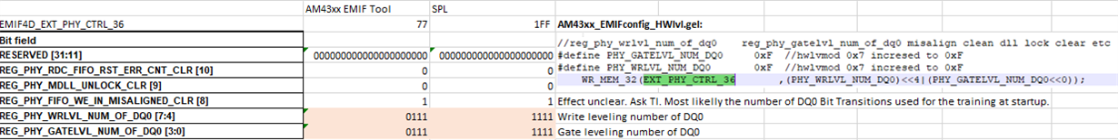

    4) EMIF4D_EXT_PHY_CTRL_36:
    Here there are different values for numbers of DQ0 for write leveling and gate leveling. I expect a larger number of DQ0 transitions to be used for the initioal training. The value from the EMIF tool is lower than the value from our implementation and from the AM43xx_EMIF_config_HWlvl.gel as well. What is the effect and what is the recommendation from TI.

  • Hi Ralph, here are some explanations.  I know there's usually a high resistance to change what has been working, so i tried to give you my recommendations along the way
    1) T_RAS_MAX: this field was only applicable for mDDR devices. The controller spec states a value of 0xF for all other DDR types
    T_CSTA: 2 chip selects are only applicable when using LPDDR2 on AM437x, this bit field is irrelavant for DDR3 one chip select designs. The tool just uses 0xF for simplicity for both types
    PDDL_UL: this was changed based on PHY spec recommendations and adding margin for process/voltage/temp variations
    Recommendation: keep what you have. The 1st two bitfields are really irrelavant to your design. Since you have done temp testing, the PLL_UL setting looks like it suffices for your design

    4) This value was optimized based on spec recommendations. The original value was mainly carried over from initial training debug and is unnecessarily conservative.
    Recommendation: keep what you have. This will only slightly affect training time
