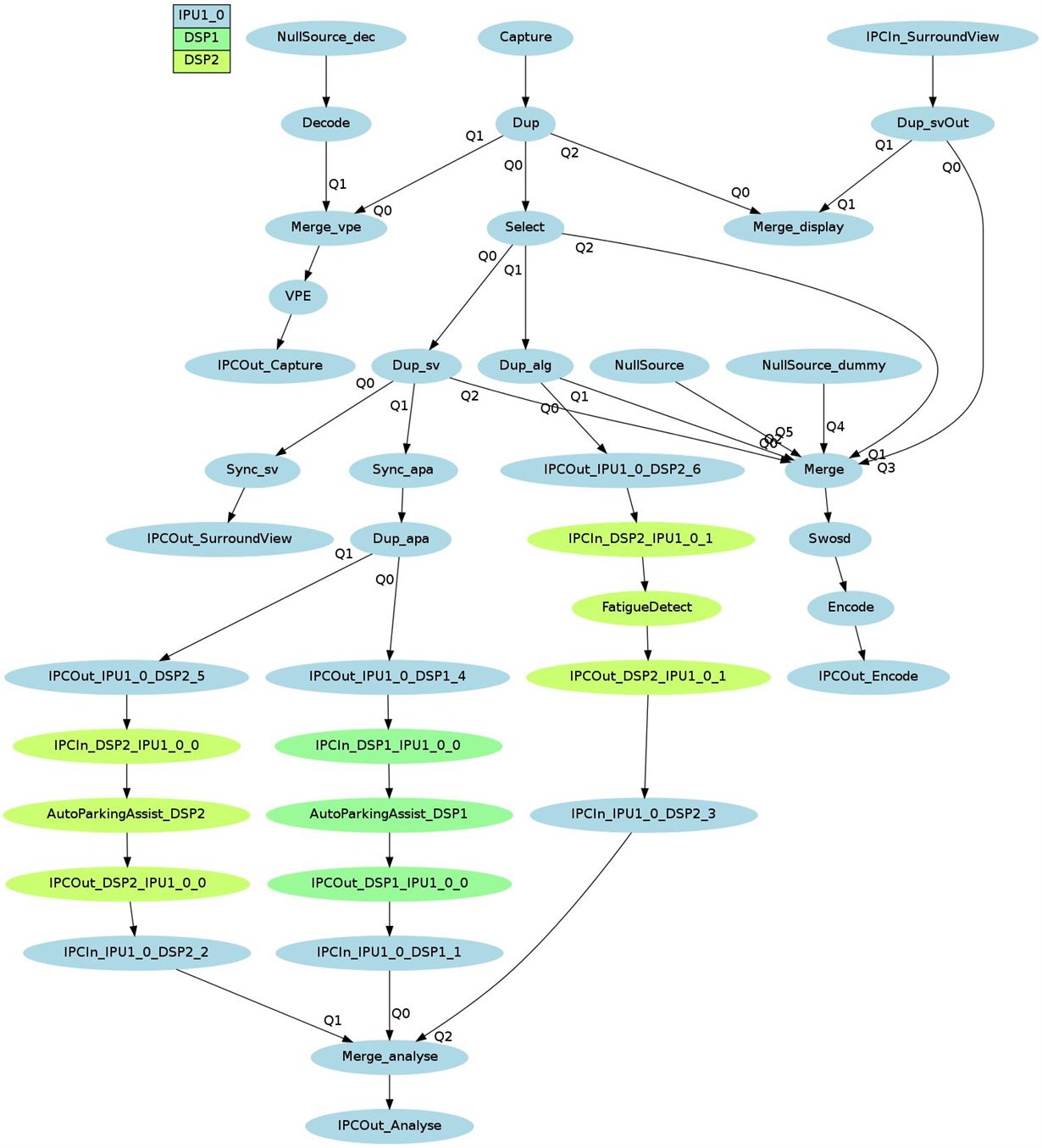

our usecase in IPU1:
7-channel capture of 720p
our usecase in a15:
take 4 yuv frm from ipcout_surroundView to do video fusion though GPU.
take 1 yuv frm from ipcout_capture  to do fd though arm cpu.

  • Hi Wen,
    IVAHD is capable of 1920x1080@60fps which means it should be able to finish decoding within 33ms.
    Are you seeing this performance drop for a specific stream and for specific frames always?
    Please check if IVAHD is configured for 532MHz from "omapconf show opp"  command.
    IVA average DDR access is 107Mbps which means very little access.
    Please refer these to appnotes.
    http://www.ti.com/lit/an/sprabx1a/sprabx1a.pdf
    http://www.ti.com/lit/an/sprabx0/sprabx0.pdf
    1) You can try to increase the priority of IVAHD first
    2) Bandwidth regulation and bandwidth limitation can  also be tried.
    RamPrasad

  • hi, RamPrasad
    it seems that the cpu loading is too high:
    LOAD: CPU: 95.4% HWI: 12.3%, SWI:26.1%

    any ideas? can we cut done the SWI?
  • hi, RamPrasad,
    i have optimize the system and the LOAD is : CPU: 78.3% HWI: 10.9%, SWI:20.3%
    but i can still observe 40ms sometime.
    please advise!!
    regards, wen

  • Hi Wen,
    Do you see this issue of decoder taking >40ms with default use case of NullSrc->Decode->VPE->Display usecase? or only with your complex chain-link usecase?
    I haven't seen the issue for 1920x1080 streams also.
    Is there a way to bypass encode part in your link and test the usecase and get the decode time?
    As there is only IVAHD, encoding and decoding will happen in sequence, so decoding time may be involving waiting time for IVAHD. To confirm this please check if you can bypass encode.
    RamPrasad
  • hi, RamPrasad,
    it's good to hear from you.
    decoder taking >40ms is observed only with my complex chain-link usecas.
    by the way, i have optimized the cpu load to 70% and the decoder take about 10-30ms most of frames(not every frame).
    i have confimed that the encoder is disabled when decode h264 which takes 10-40ms each frame.
    this is what i have tried:
    1. trid decode h264 frm which cames from j6 h264enc, but nothing changed.
    regards, wen
  • hi, RamPrasad,
    sorry for the long-delay. i have successfully created a simple use case that you meantioned in the previous post:
    UseCase: chains_decVpeDisplay(the VPE link drops all the data from the previous link)
    NullSource_dec -> Decode -> VPE -> IPCOut_Capture
    after a little while, i found that the cose is <8113us which is quite good.
    what should i do to shot the reason why i got big cose with the complex use case ?
    this post has also told about DDR bandwidth when vpe is in de-interlacing mode,should i check it?

  • Hi Wen,
    Yes 8ms decode time is correct for a 720p resolution. As I mentioned earlier, your usecase involves multiple IPs with multiple tasks and causing IVAHD to content for DDR and this is resulting in performance drop.
    Unfortunately you need to do multiple trial and error experiments to adjust Bandwidth regulation and limitation + Prioritization (as mentioned in the appNote I pointed).

  • hi, RamPrasad,
    i understand there will be a long shot to find the correct regulation & prioritizations configuration, and i will start dig more with your guidance.
    but now, i'd like to find data evidence that the root cause is the DDR Bandwidth restriction, and, for you information, the result of
    M4 statCollector cannot tell the cause in the original post(maybe i had omitted something & wrong configuration).
    many thanks.
