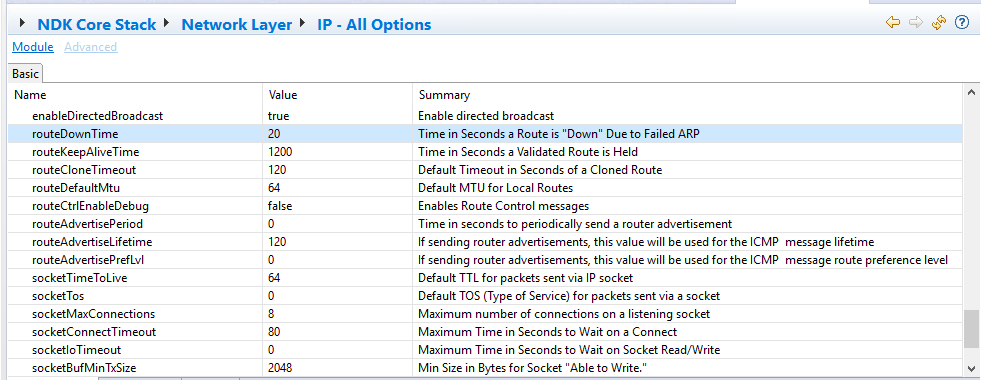

  • Stefan,
    The easiest way to update the ARP and TCP connection timeout is probably to make change from .cfg file:
    Also you may have figured out to use APIs like:
    Int timeout = 1;
    CfgAddEntry(hCfg, CFGTAG_IP, CFGITEM_IP_SOCKTIMECONNECT,
                CFG_ADDMODE_UNIQUE, sizeof(uint), (UINT8 *)&timeout, 0);
    Garrett
  • Hi Garrett,
    I haven't tried it yet but I think the numbers don't add up properly:
    • I have 3 pending connections in my backlog
    • It takes about 11 minutes for the NDK to clean it up
    • routeDownTime is 20 seconds in my case
    • CFGITEM_IP_SOCKTIMECONNECT is on 24 seconds
    • I don't see any combination of these numbers add up to 11minutes
    I think something is missing, but I will give it a try...
    Best regards
    Stefan
  • Hi Garrett,
    so I've set
    • routeDownTime and
    to one second and it didn't help.
    Could you ask somebody from the NDK team who knows which timers have to be touched in the described scenario as two different protocols (ARP and TCP) interacting each other in an unusual way.
    Thank you and best regards,
    Stefan
