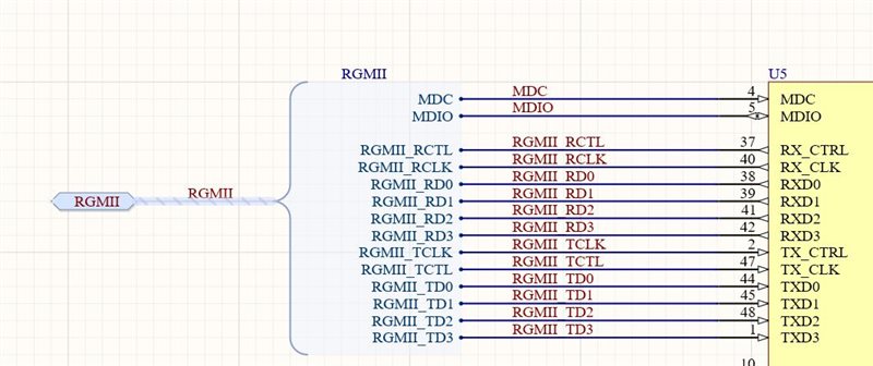

    This is step 1 of what I need help with. I'm totally lost on what a "good setup" is. The links you posted have a totally different method than the old wiki and neither of them seems to work. I can't get a valid IP address on anything I plug into the Ubuntu machine.

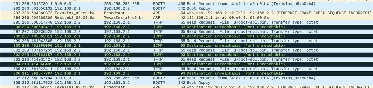

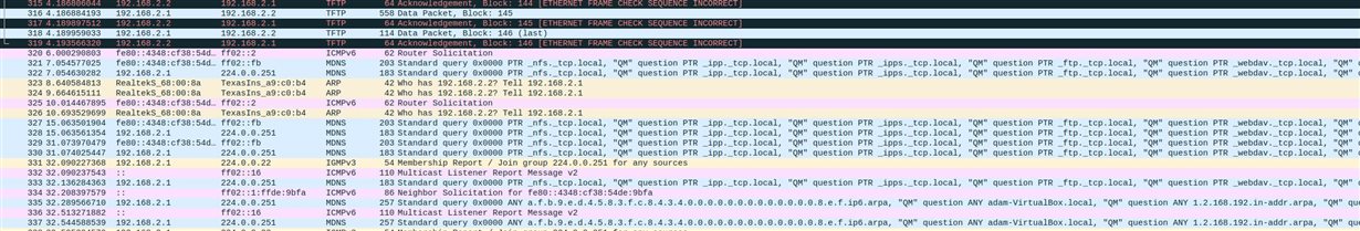

  • Alright, another day down the drain spinning my wheels. I looked at the traffic on my Ubuntu machine using wireshark and I don't think I'm getting any traffic from the board, which is weird because the PHY is up, and I can talk to it in u-boot, and it establishes a link.
    I enabled the Marvel drivers in u-boot. The only thing I can think of is the "Enable Driver Model for Ethernet drivers" option in menuconfig. Again, I'm totally lost by where the support is for this.

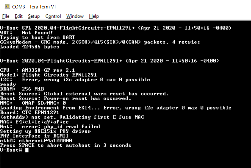

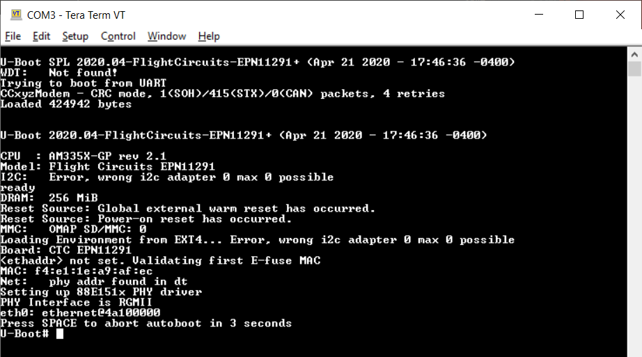

  • I've tried that.
    Can we take a step back and get back to my u-boot port. I'm not convinced I've enabled ethernet properly.
    https://e2e.ti.com/support/processors/f/791/t/840520?66AK2H06-U-boot-cannot-initialize-88E1512-Ethernet-tranceiver-properly
    This is a very similar PHY to what I'm using and seems like a similar problem. I don't know what's up with the dts in u-boot, per my previous comments. Do I need to update ethernet support to this new driver model, and create a dts and all that? I haven't created a dts for my board, and u-boot never seemed to care. I haven't seen anything about how to go about this.

    cpsw_eth_of_parse_slave: phy_mode=mii slave_data->phy_if=0
    Which confirms that DTS gettings get parsed and used. You don't need to instrument your code like this, I'm just showing how DTS information is important to get Ethernet/PHY setup right with the current U-Boot. If you insist on using an older unsupported U-Boot you need to double-check/migrate the PHY mode settings accordingly which is where your issue could be.
    I'll give that a try. I'm using 2019.04 from the eewiki site. The am335x_defconfig had to be very heavily modified because I don't have a lot of the things the evm does and it wouldn't compile and/or run.
  • CONFIG_DM_ETH wasn't enabled. When I do that I get compilation errors:

  • Hi Adam,
    How did you enable this? Via "make [...] menuconfig"? Looks like there are some unmet dependencies (CONFIG_DM_GPIO?). But working through those steps little by little can be challenging, especially if one has not much experience with U-Boot. Hence I'd like to re-iterate my earlier suggestion of starting with the U-Boot that is part of the current Linux SDK, which has CONFIG_DM_ETH (and also CONFIG_DM_MMC) already enabled, for a better starting point for experimentation.
    If for some reason you must use the old U-Boot you are using please point me to the exact(!) U-Boot git tree you are using so I can have a look how to change PHY settings with that particular version of U-Boot.
    Regards, Andreas
  • Andreas,
    I have CONFIG_DM_GPIO enabled as well.
    It's not really that I must use this version, it's just what I've been using. It took me forever to even get something compiled so I'm not too keen on starting over with a different version. The SDK stuff is so dependent on hardware being the same as the EVM's with the EEPROM and all that I don't have, it was a pain getting all that out.
    I used mainline v2019.04 with these patches: https://github.com/eewiki/u-boot-patches/raw/master/v2019.04/0001-am335x_evm-uEnv.txt-bootz-n-fixes.patch

  • Alright, I've been fighting this for a couple more days now. I've moved to mainline u-boot v2020.04 to use the driver model as in the SDK. I have to be close now and I just a have a couple questions that will hopefully keep me moving in the right direction:
    I get in my u-boot boot log: "Net: error: phy_id read failed"
    I think this may have something to do with the phy not working well. I've verified that my MDIO interface is working... once booted I can talk to the PHY. I also verified it's loading the correct Marvell drivers. I just can't figure out where that error message is coming from. any clues?
    Another oddity is that if I don't do the pinmux in the board file the ethernet doesn't work at all, even though it's defined in my dts file as well. What's up with that? Do I really need both? Is something wrong with the setup of the dts? The dts definitely seems to be working, I can make changes and see the results when compiled and booted.
    Lastly, and this isn't really an issue, but an annoyance, is there any way to get rid of the I2C lines? I don't have I2C, I have it disabled in the configs, etc. but the "Error, wrong i2c adapter 0 max 0 possible" error keeps showing up.
  • OK, got the phy_id error sorted. It was in CPSW.c if it failed to find phy-handle it would look for phy-id then fail that if it found neither, and since phy-id is no more, I was looking in the wrong spot. Apparently I was missing “slaves = <1>” in my dt. All good now. Ethernet still doesn’t seem to work though.
    I have to see if I can figure out loopback on the PHY or something, at this point everything looks like it should be working but just… isn’t.

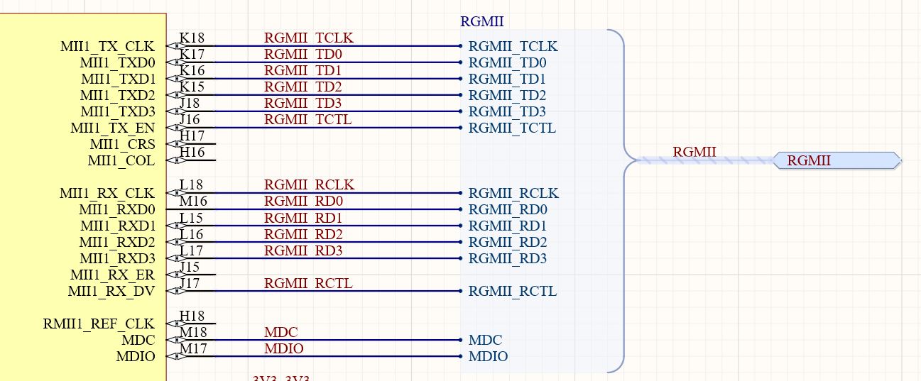

  • I tried the first two fix-ups. The I2C messages are gone, device tree pin control is still giving me a hard time though, I enabled those two CONFIGs and I still have to use the pin mux from board.c to have the MDIO return valid data on the PHY.
    Yes, I've tried "rgmii" "rgmii-id" "rgmii-txid" and "rgmii-rxid" with the same results across the board... no packets sent.
    The PHY is a Marvell 88E1510-A0-NNB2I000. Here are the two schematic blocks:
    This is the AM3352 side:
    This is the PHY side:
    Pretty basic... I'm using the AM3352 internal pull ups on the MDIO and MDC lines. If you'd like the whole schematic I can send it via email.
    Thank you for the help!
    Adam
  • Holy friggen crap, I have TCTL and TCLK mixed up Well, that's embarrassing haha.

  • Adam,
    Careful, sometimes it's not as easy as this. You need to make sure that there are no conflicts with board code that may still be getting called. Then, if you need pinmux done in SPL, the respective DTS nodes may need to get marked up with u-boot,dm-spl otherwise they'll get stripped out during SPL build and nothing will work. If you want to use DTS-based pinmux it'd probably be worth looking at an AM335x-based platform that already uses it (there are some in the U-Boot tree), and see how it is managed from a DTS and platform code perspective.
    Regards, Andreas
  • Adam Gerken1 said:
    Thanks again for the help, got a lot of other minor things smoothed out along the way, and I know u-boot way better than I did before, so that's something.
    You definitely struggled through a good cross-section of potential issues and U-Boot quirks. Some of that stuff can be mitigated with better documentation (we are trying this), and some of it just requires some elbow grease to struggle through it in my opinion. Learning curve is a bit steep but yes it does get easier.
    Adam Gerken1 said:
    I am still curious about the dt pin muxing issue though, I'd like to push this towards the driver model as much as I possibly can and whittle down the board file dependence.
    See my other comment. Probably want to pick an existing board with DT-based pinmux config and model from there.
    Regards, Andreas
  • OK, new hardware is in and it's looking much more promising now! I actually get traffic on the ETH interface but now I'm back to square one and still confused exactly how to move forward.

    Lastly, I still can't get the MDIO/MII pinmux working strictly via the DM, even when copying an evm config but that's super nitpicky at this point, I just want to get this thing booted and move on.

  • I had the RGMII TCTL and TCLK signals mixed up between the AM3352 and PHY. reworking them wasn't possible so I had to have new boards made.

  • Andreas, Getting close now, I can taste it. I've got my DCHP/TFTP server set up per the instructions. It took a little monkeying around. There's a typo in the example config that took me longer than I'd like to admit to find:
    elsif substring (option vendor-class-identifier, 0, 10) = "AM43xx U-B"
          filename "u-boot-restore.img";
    There's two open brackets there.
    Anyway, I've now got it up and running and getting an IP address and everything but I'm getting an ICMP error and no file transfers. Any ideas? I've made sure there are no firewalls in the way, tried a switch between the board and PC, rechecked my set ups, etc.

  • Here's the end of the TFTP transfer. THe ERRORs are erroneous, I found another post about it. There are no actual packet errors recorded if I do an "ipconfig."
    After this the board disappears, nothing from 192.168.2.2, no request for u-boot, nada. I agree it's most likely an spl configuration issue, I just have to back and double check everything.
    If I may make a suggestion I would probably recommend going back to how networking is setup on one of the existing platforms from a DTS, CONFIG_*, and platform data POV as a known good starting point. I think you may have since made various changes in an effort trying to get various things working, but what may be needed now is to just go back to a known-good starting point as used on an existing platform. It should not be too hard to get this over the hump with what you already have working now.

  • Finally getting back into this project... I found some SPL configs that weren't enable to allow Ethernet and such. I think I got that sorted out but now the spl just requests u-boot-spl over and over instead of moving onto the u-boot image. Still no serial out.
    I'm going to try loading this spl through uart and seeing what happens. Maybe it's resetting or something.
    EDIT: yeah, SPL is now just causing a reboot after it loads.
    EDIT 2: The older imagines I made based on the eewiki patches loads the SPL and gives me an "Unsupported Boot Device" error at least the board is alive and I just have to find the right combo of booting magic.
  • Adam,
    Sounds like (and you had mentioned that earlier) that you have no serial output at all. The issue with serial port bringup in SPL is that it happens very late into the SPL startup, past failure-prone things like board detection logic (if still there) and DDR bringup. Can you enable the early debug UART as per instructions here (scroll down to "Setup early (debug) UART"): software-dl.ti.com/.../U-Boot.html
    This might give you some additional clues. And enable you to add printf() statements to trace program execution to help narrow down where it is failing.
