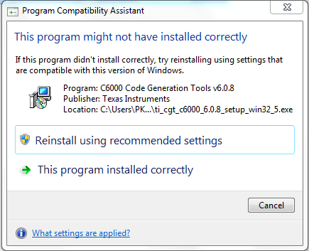

Is " ti_cgt_c6000_6.0.8_setup_win32_5 " compiler compatible with Win7?
I installed it and a windows compatibility service message appeared as below:

C6000 compiler version 6.0.8 was released in October 2006. At that time, Windows XP was dominant. Windows 7 was released in 2009. So, this version of the compiler was never tested with Windows 7. That said, I would expect it to work. I've seen even older versions of the compiler work with Windows 10.
