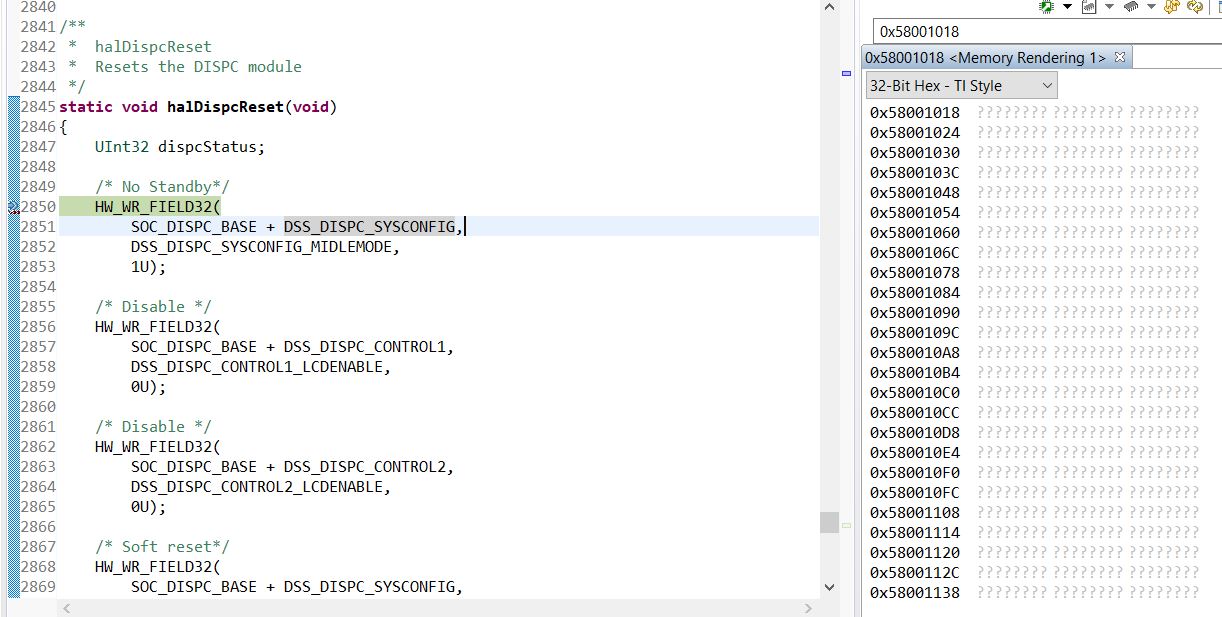

  • Hi Brijesh,
    While running DisplayDSS vision sdk code on our own ECU, we are not able to access the memory mapped register. I have attached debug image.
    Naresh
  • Hi Naresh,
    How are you running this example? Are you running after loading and running gel files on A15?
    Please note that without running 'OnTargetConnect' Option on A15 gel files, this example can't be run. This option powers on the modules and enables clock..
    Rgds,
    Brijesh
  • Hello Brijesh,
    I am running the code on IPU1 C0. Yes, I am running by loading the gel files and running the script TDA2Px_MULTIPLECORES_EnableAllcores, OnTargetConnect and IPU1SSClkenable_API. Then Load the vps_examples_displayDssWb_ipu1_0_debug.xem4 on ipu1 c0.
