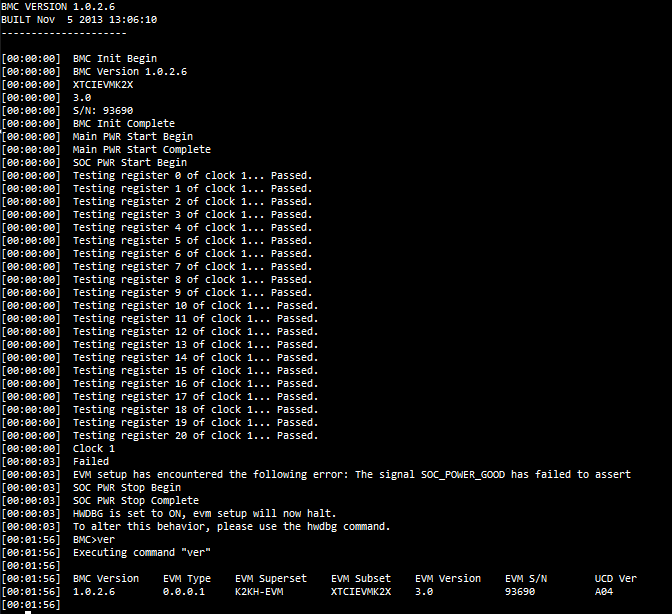

Hello community,
We are using XTCIEVMK2X EVMs for our project. The version of the EVMs we use are v3.0. Accordingly, default BMC versions were 1.0.2.5 and UCD versions were 104_A02, 78_A02 and 52_A03.
We searched SOC_POWER_GOOD in Technical Documents and here in e2e.ti, It seems that some SOC_POWER_GOOD problems can be resolved with UCD Update.
First of all, we tried UCD Update, But bmc_tool.py script always failed(i2c error). So we searched bmc_tool.py i2c error, It seems that some i2c errors can be resolved with BMC Update.
So, we tried BMC Update according to BMC_In-Field_Update, BMC has updated from 1.0.2.5 to 1.0.2.6. With 1.0.2.6 version BMCs, bmc_tool.py has succeed to update UCDs without error. But, when UCD versions have been got with bmc_tool.py, results seems corrupted like below. What is the reason for this corruption? If UCDs updates completed without error but with this corruption, can we say updates completed successfully?
After updates, BMC outputs here;
1.0.2.6 version BMC firmware and 104_A02-78_A02-52_A03 versions UCD firmwares are the most current versions we can find. Is there any newer versions for any of them?
We haven't been working for a while due to "SOC_POWER_GOOD " error on the cards. How can we overcome this problem?

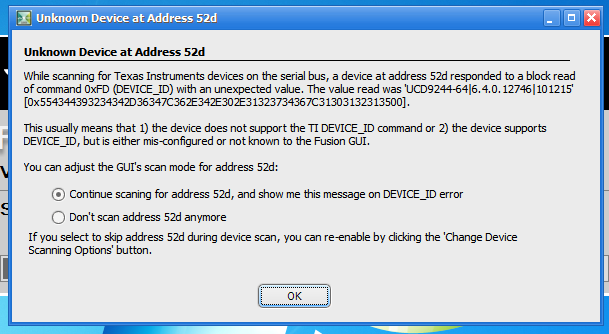

  • Hi community,
    Power problem still continues.
    We searched alternative ways to overcome Power issues when we can't get result with "bmc_tool.py".
    First of all, we tried to reconfigure UCD Power chips with Fusion Digital Power Studio v3.0.42,  but Errors occured for all chips like this "Unknown Device at Address 52d&78d&104d".
    We tried Fusion Digital Power Designer v7.2.1(for an alternative to Fusion Digital Power Studio v3.0.42). With this program, There was no "Unknown Device" errors, unlike previous one. when we tried "Import to Device" options for all devices(52, 78, 104),  Only one of them completed without error(Only 104 successfully completed). "WRITE VERIFICATION READ BACK FAILED" errors occured for other two devices.
    Here is all outputs belongs to 3 Devices:

    We are facing this "SOC_POWER_GOOD " error in 2 different EVMs in our hands, and we become unable to work with EVMs.
    How can we solve this problem? Is there a different method we can try?
    We are waiting for your suggestions.
    Thank you,
    Srt

  • Hi Rex,
    Thank you for your reply.
    UCD update had looked successful with "bmc_tool.py", but  "SOC_POWER_GOOD " error continued.
    So we tried Fusion Digital Power Designer as I mentioned in the previous post. "WRITE VERIFICATION READ BACK FAILED" errors occured with Fusion Digital Power Designer. I added Fusion Digital Power Designer output files to the previous post. But "SOC_POWER_GOOD " error still continues.
    Thank you,
    Srt
  • Hi, Srt,
    When you updated UCD, did you use python tool of bmctool.py or LM Flash Programmer? Most of the time, we used bmctool.py to update the UCD.as described in 6.3.7.1.3 of the EVMK2H Hardware Setup Guide. In 6.3.7.2 of the Setup Guide, there are steps to do the BMC in-field update using LM Flash Programmer. I have not used Fusion Digital Power Designer on K2H and not sure if that is the correct tool.
    There are the 2 ways I know of and are documented in the Setup Guide.
    Rex
