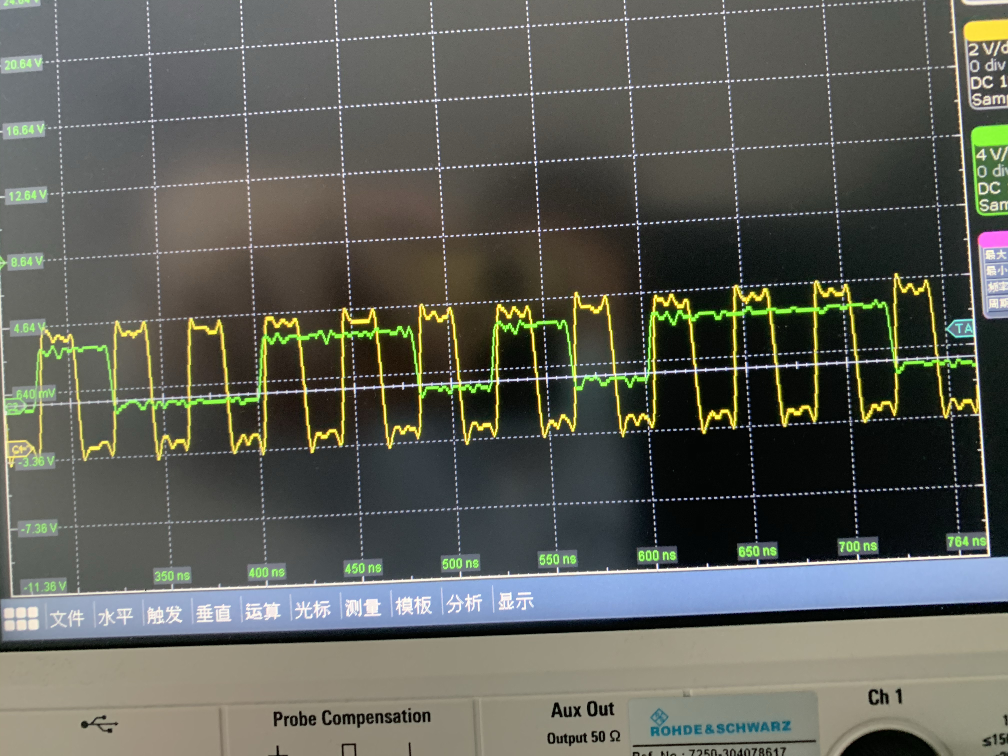

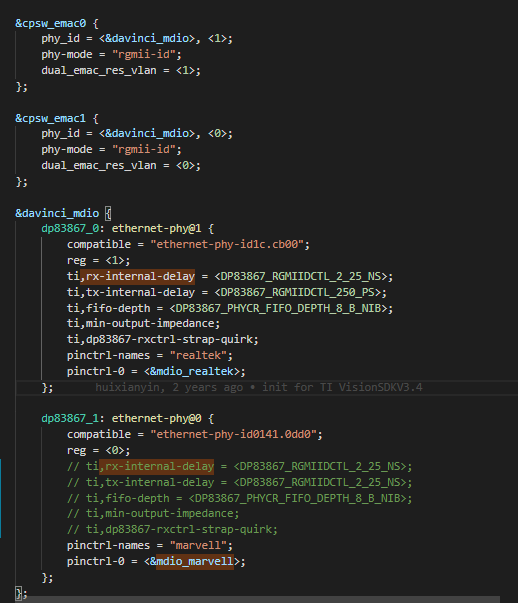

When I switch ethernet to 1Gbps, log shows below, but can't send or receive any packet.
[ 908.679337] cpsw 48484000.ethernet eth1: Link is Down
[ 910.690381] cpsw 48484000.ethernet eth1: Link is Up - 1Gbps/Full - flow control rx/tx
My network circuit like below:
* sorry for my terrible drawing...
As picture shows, TDA2Px use RGMII1 and MDIO to connect phy chip: 88E1512. And single from RGMII1_RXC and RGMII1_RXD0 shows below:
* 1000Mbps speed.
Since my oscilloscope detecting pens' bandwith is lower than 500Mhz, RGMII1_RXC shows like sin wave. But as I only series resistance between TDA2px and 88E1512, this wave actually should be square wave.
*100Mbps speed
And RGMII1_TXC and RGMII1_TXD0 has similar wave. So I think RGMII1 works fine.
And I read similar question: http://e2e.ti.com/support/processors/f/791/t/759078?Linux-AM3359-Ethernet-PHY-1Gbps-not-working
And dump DPLL shows clock is already enabled with 250MHz. And WR_RGMII_CTL register setting alright. Please refer my attachment.
I'm really clueless now. Would you please give me some suggestions?
Thanks a lot!
