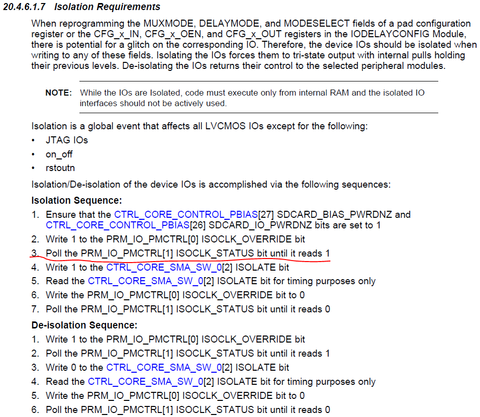

I found about ISOLATION requirements sequence.
it seems happened error for PRM_IO_PMCTRL[1] ISOCLK_STATUS bit not set to "1".

    could you let me know why don't work 3rd step of Isolation sequence as below picture.
    please advise any comment me about  Isolation sequence...

    Now they want to check Isolation sequence why stop at 3rd step.
    please advise me any comment. then I will check it.
