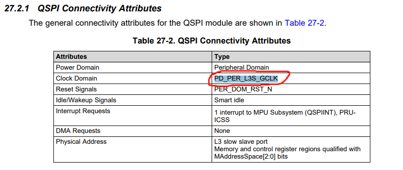

  • I think I find the reason why cann't access the QSPI registers.  The clock domain of QSPI is PD_PER_L3S_GCLK, but it's not open.
    The value of  PRCM_CM_PER_L3S_CLKSTCTRL of my am437x system is 0x801, and  the bit 8 (CLKACTIVITY_ L3S_GCLK) is 0.  So fail to access the QSPI registers.
    But it's sad  I donn't know how to  enable PD_PER_L3S_GCLK although I have searched the whole manual book (AM437x Technical Reference Manual 2018) several times.
    Would you help me how to enable PD_PER_L3S_GCLK  please?  Thanks!

    The PD_PER_L3S_GCLK clock should get enabled implicitly when any of its consumers are requesting it (for example, in case of QSPI, when PRCM_CM_PER_QSPI_CLKCTRL is set to enable that module). How are you seeing 0x801 for that register?
    When I read this from my system I get 0x1102. This is on a standard AM437x EVM booted our SDK from SD card.
    root@am437x-evm:~# devmem2 0x44DF8A00   ;# Read PRCM_CM_PER_L3S_CLKSTCTRL
    /dev/mem opened.
    Memory mapped at address 0xb6f9e000.
    Read at address  0x44DF8A00 (0xb6f9ea00): 0x00001102
    root@am437x-evm:~#
    Here you see bit 8 is turned on, meaning the L3S_GCLK clock is active. Actually sometimes I read 0x1902 from that register, which points to MMC activity which makes sense, and it shows we are looking at the right register.
    Also if you want to study the device clock system some more, there are two tools you can actually use. One is the clock tree tool, to visualize and understand how clocks are dependent on each other and how the hierarchy looks like. Then, there is omapconf, a command line tool already part of our SDKs. You can actually export the clock configuration from a live device (via omapconf export ctt) and then import it into the clock tree tool to visualize it. Have a look at the below links for more info...
    http://www.ti.com/tool/CLOCKTREETOOL
    https://github.com/omapconf/omapconf/wiki
    Regards, Andreas

    I know the reason why can't access qspi registers.  If there are no devices in domain of L3S_GCLK used, the clock will shut and go to sleep.
    So it must set PRCM_CM_PER_L3S_CLKSTCTRL before accessing qspi registers.
