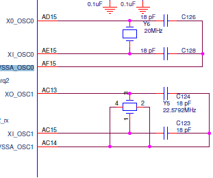

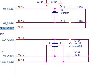

TDA2P-ACD: VSSA_OSCx connection to GND
Part Number: TDA2P-ACD
Dear TI Team,
Source: SPRS996F –MARCH 2017–REVISED FEBRUARY 2019
Figure 5-12. Crystal Implementation. It is not clear enough either VSSA_OSCx must be connected to GND or not.
(Figure 5-14. 1.8-V LVCMOS-Compatible Clock Input. In this case it is quite clear connection to GND)
Therefore the following question arise at this point. Should be VSSA_OSCx (x=0, 1) connected to GND? If so, Analog GND or Digital GND? Is there please any requirement/specification/recommendation for a correct layout?
Thanks so much in advance. Best Regards,
Javi
