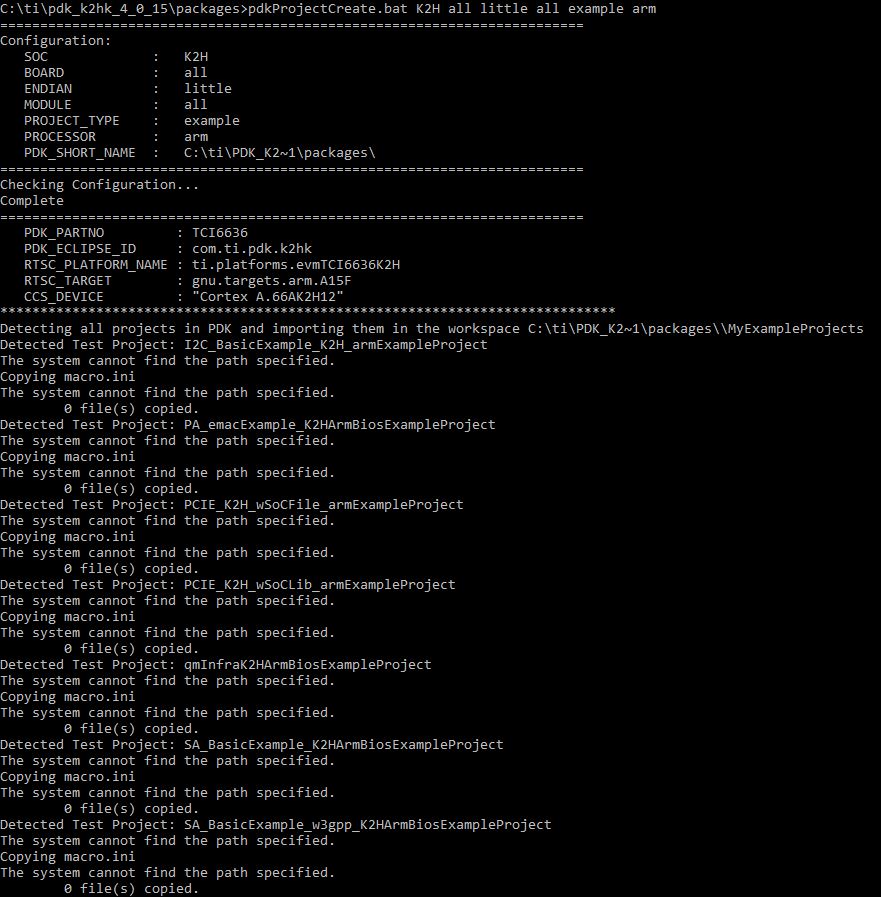

  • Dear Rex,
    Since I use Windows OS so I run the batch file pdkProjectCreate.bat on command promt and encouter the error:
    Do I miss any step?
    Thanks.
  • Hi, Chanh,
    I think you miss one argument when execute the .bat file. The path showed up as packages\\MyExampleProjects. Check the .bat file for correct argument to pass.
    Rex
  • Hi Rex,
    I found the issue is with the CCS directory defined in the bat file, I am using CCS 9.2, but the file define the directory of CCS 9.1.
    After import all sample project, I still can not find the DMA for ARM example that similar to C:\ti\pdk_k2hk_4_0_15\packages\ti\csl\example\edma (which I already can run on DSP).
    Thanks.
