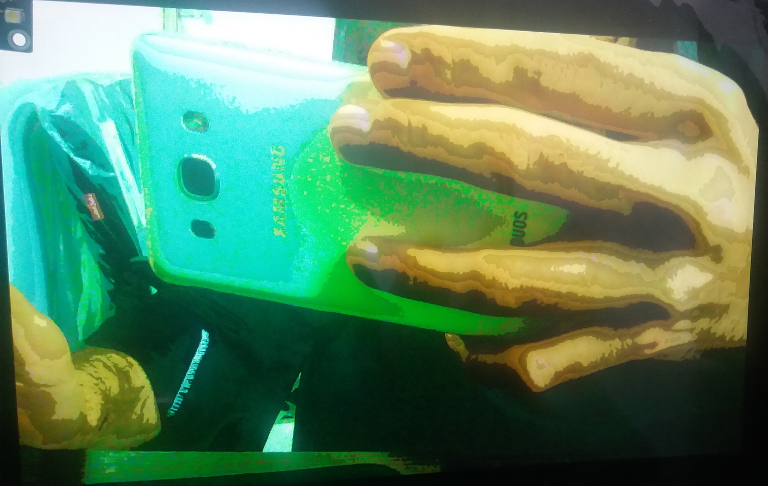

    I used the captureVip example available in TI RTOS SDK to capture a video and store it in SD card... using Vooya, i.e. offline YUV viewer, the result is still the same with bad output color... I guess this means the problem is either with camera configurations or the VIP configurations ... Am I right?
    back to previous scenario, In loopback example, I'm using the changes in attachment for my test:

    ***Changes_in_loopback_main.c: it adds an entry to loopback_main.c for my test
    ***Changes_in_loopback_test.c: my changes to loopback_test.c ... specified by MY_CHANGES comment in file

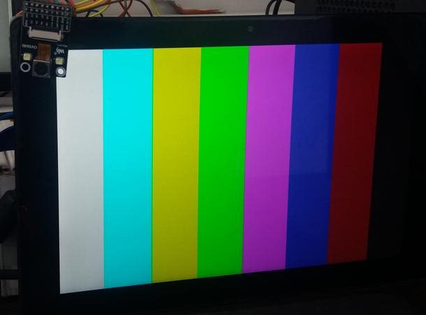

    one important thing is that when I enable test pattern on ov5640, I get the pattern right with no bad output color ... test pattern picture taken by my cellphone from IDKAM572x screen is in attachment
        {0x503d, 0x82, 0},  //test pattern
        {0x4741,  0x00, 0}, //test pattern
    Question: what could be the problem base on my changes that make the output not having good colors?? I tried many things but none of them worked ...
    I guess answering my question will help other TI users to integrate a new camera with TI RTOS SDK
    Thanks in advance ...4743.attachment.zip

    the test pattern colors are correct i.e. back, green and etc bars BUT the video has the same issue

    I'm doing my tests on TI-RTOS, Not Linux, so I don't use device tree.
    Here is the memory dump of the first frame for test pattern... I have only send you the first line of the frame in attachment
    And here is the picture taken by my cellphone from IDKAM572X screen (as you can see colors are shown properly):
    My settings for camera and Loopback example was YUV422-UYVY 720P (1280*720) and the test pattern has 8 bars (black, red, blue, ...., white) of equal size, so each bar would be 1280/8=160 pixels ... as YUV422 uses 2 bytes for each pixel, so each bar would be 160*2=320 bytes of data ... as you can see in the attached file, each bars data is also 320bytes (I have annotated it in file) .... It shows that when I ask camera to send me test pattern data, It sends it correctly and RTOS Loopback example shows it properly as well, But when I ask the camera to send a live video, It will send me frames of like the one I sent you previously (you said the problem might be chroma mixed)
    Base on my tests, I guess that the camera is not configured properly to send me videos of YUV422-UYVY 720P at 60fps
