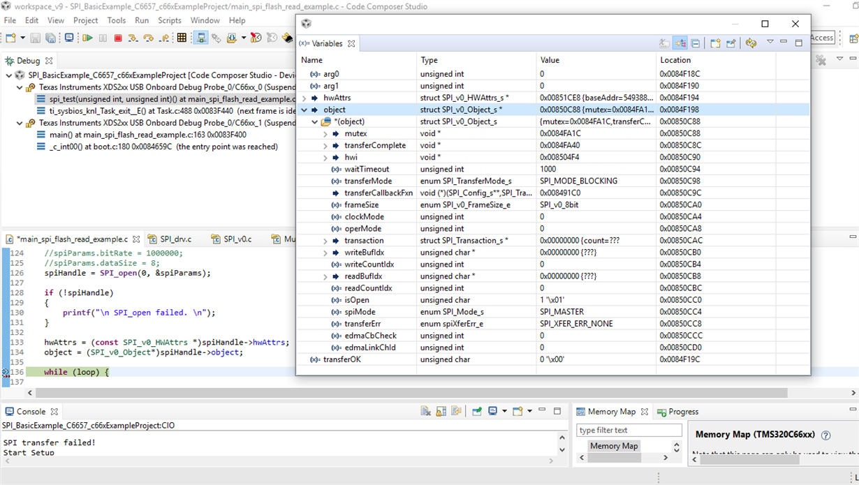

Hi, I am working with TMDSEVM6657 evaluation board. I am trying to establish simple SPI transmission to CS0 port.
If I set the spiParams.transferTimeout = SPI_WAIT_FOREVER; then it gets stuck in SPI_transfer line (waiting for the semaphore), and if I set the transfer timeout to be a certain number, then it finishes transfer with the message SPI_TRANSFER_TIMEOUT.
I am using the SPI_BasicExample_C6657_c66xExampleProject, where I only changed the main_spi_flash_read_example.c file, nothing else.
This is what I use:
This is how my code looks:

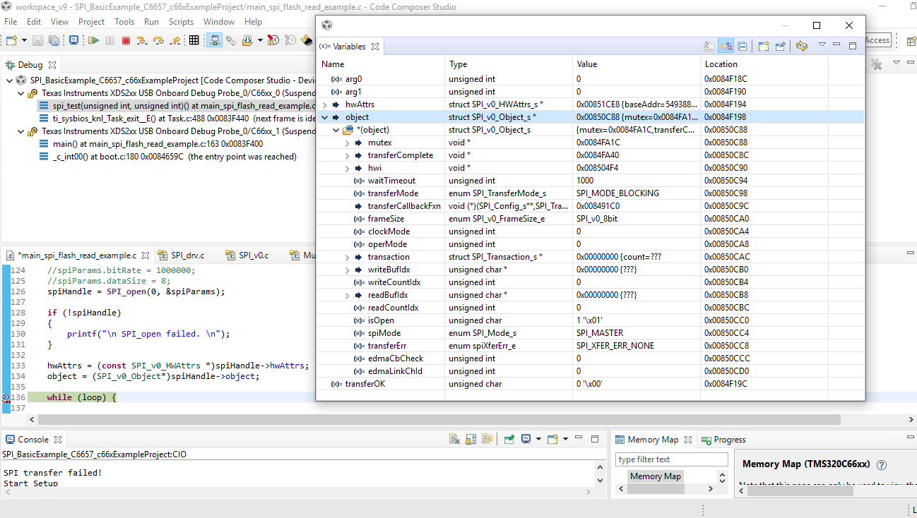

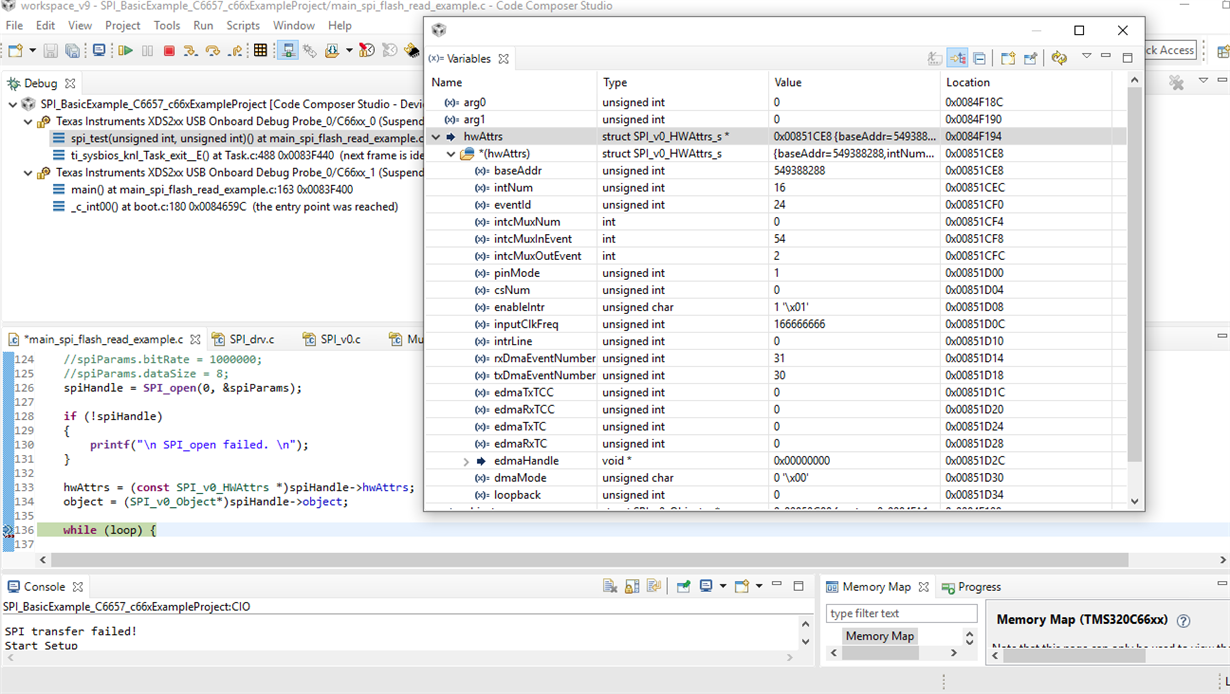

Here is how the hwAttrs and object variables look like after opening the SPI_open:
And here is the outline of Variables before returning from SPI_transfer function in case when spi timeout is 1000:
What could be the reason for this?
If I can provide more information, please let me know.

    What is the slave device in this case? Do you see anything on the pins at all? Any scope shots you can provide would help.
    If you can provide a snapshot of the SPI registers before and after starting the transfer that would help as well.
    I noticed you did not specify a frame format. The default is SPI_POL0_PHA0, please ensure this matches what the slave device expects.
    You also did not specify a pin mode, I believe the default is 3-pin mode. If you want to use CS, e.g., 4-pin mode, you can add the following in Board_initSPI().:
    spi_cfg.pinMode = SPI_PINMODE_4_PIN;
    You can also do this in spi_soc.c but you will need to rebuild the driver afterwards.
    EDIT: Just saw pinMode is 1 in your variable window which indicates 4-pin mode so this is not the problem.
    You may also need to disable interrupts if not using them:
    spi_cfg.enableIntr = false;
    Sahin

    Here are the registers that I see, but I don't recognize the SPI registers:
    Shouldn't they be here?

  • Dejana,
    The SPI registers are not necessarily in the CCS register window. You may use the CCS memory window for that, the datasheet shows the SPI registers starts from 0x20BF0000.
