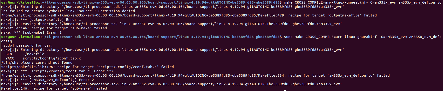

3)I got an error when I executed the following command referring to "3.1. U-Boot".
Are there any measures?(The 2nd time is when "sudo" is used.)

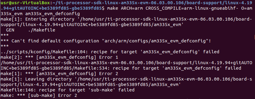

    3)As for the error of, when I tried "sudo apt-get install bison" and "sudo apt-get install flex", I got the following error.
    So I ran make on the "u-boot -2019.01+gitAUTOINC+333c3e72d3-g333c3e72d3" directory where am335x_evm_defconfig is located and it worked.
    Is this procedure okay?
    O.H
    Looks like you were trying to build the Kernel, but your this $SUBJECT is about U-Boot??
    Anyways if you really want to build the Kernel it seems like you are missing the step that creates the SDK default configuration (it is something you have to do), see "SDK Kernel Configuration" section in http://software-dl.ti.com/processor-sdk-linux/esd/docs/latest/linux/Foundational_Components_Kernel_Users_Guide.html
    Here you are building U-Boot, which includes defconfigs for each boards, so that looks okay.
