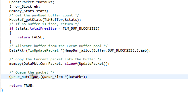

Summary: We have noticed  issue in  allocating memory blocks in external DDR memory
HeapBuf_alloc function  is used to allocate memory in DDR for Bios Queue . We are allocating memory only when if it has free space. In some instant this function returns zero even though it has enough free size. Based on E2E  , we have changed HeapBuf_alloc function with Memory_alloc , But no improvements. Next step we tried to move this Buffer memory section from DDR to Processor IRAM , this memory section changes fix the issue. We don’t want to keep this it in IRAM, since IRAM doesn’t have enough memory . We have used similar memory allocation in another Queue handling , we didn’t find any issue with that. Only difference is this problem  Queue will be called by multiple thread in same time.,  Please provide your thoughts and your inputs are highly appreciated.

    Available free space is checked as below before allocating memory
  • Thanks for the code snippet. I see a few things
    1. Please use Memory_alloc instead of directly calling HeapBuf_alloc.
    2. Please initialize the Error_Block before using it. Here is how to do it.
    Error_init(&eb);
    3. Are you seeing DataPkt be NULL?
    4. Your code is not thread-safe. You could see there is memory present (via the HeapBuf_getStats), but then before you call the alloc, a higher priority thread runs and allocates all the memory from the heap. Then when the above task returns, there is no memory. Could this be happening? I'm assuming you are only allocating memory from tasks. You can put a Task_disable before you get the stats and Task_restore after you allocate the memory (and in the if no memory case).
    5. You are using TLMBuffer in the HeapBuf_getStats and Buffer in HeapBuf_alloc...are these two the same thing?
    Todd

    Uint8 QueueDataPacket(UpdatePacket *CurrPacket){ UpdatePacket *DataPkt; Error_Block eb; Memory_Stats stats; Error_init(&eb); Uint32 key; key=Task_disable(); /* Get the un-Used buffer count */ HeapBuf_getStats(Buffer,&stats); /* If no buffer is free, return */ if (stats.totalFreeSize < TLM_BUF_BLOCKSIZE) { return FALSE; } /* Allocate buffer from the Event Buffer pool */ DataPkt=(UpdatePacket *)Memory_alloc(xdc_runtime_IHeap_Handle(Buffer),BUF_BLOCKSIZE,8,&eb);
    /* Copy the Current packet into the buffer */ memcpy(DataPkt,CurrPacket, sizeof(TlmUpdatePacket)); Task_restore (key); /* Queue the packet */ Queue_put(TQue,(Queue_Elem *)DataPkt);
    return TRUE;}
