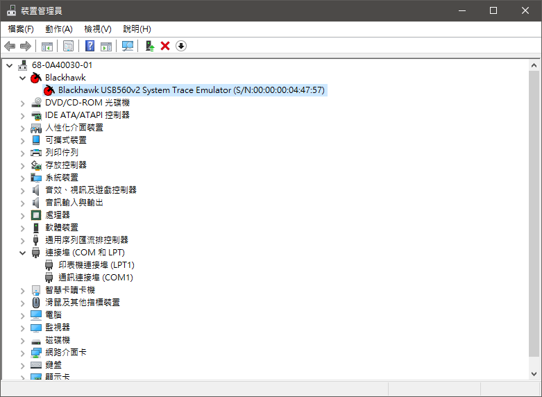

I am struggling in flashing the QSPI Flash of AM437x IDK over JTAG interface.
Using Uniflash v4.6.0 on win10(64bit) with the ti binary file generate by CCS8.3.1.
I use Blackhawk USB560v2 Emulator first, but end up with <Error -2083 @ 0x0> when loading Programming FlashWriter.
So I use XDS100v2 Emulator on the IDK board instead.
Here is the command I use
dslite.bat --mode load --config=C:\ti\EDT1704_3\AM437x_XDS100v2.ccxml -f C:\ti\pdk_am437x_1_0_16\packages\ti\board\utils\uniflash\target\bin\idkAM437x\uart_idkAM437x_flash_programmer.out -n 1
dslite.bat --mode processors -c COM4 -f C:\ti\EDT1704_3\ecat_endat_3_20200227_ti.bin -d 2 -o 0
dslite.bat output success of Flash Programming
But when I restart the power of IDK board, the board seems like not running.
Did I miss any steps?
How can I flash the QSPI Flash with Blackhawk USB560v2 Emulator?
