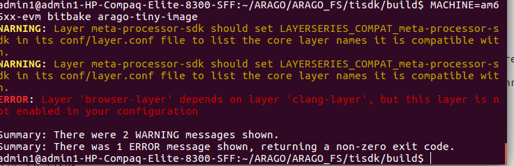

    I try to follow the instruction as per  http://software-dl.ti.com/processor-sdk-linux/esd/docs/06_03_00_106/linux/Overview_Building_the_SDK.html
    I am getting error as below
                    /ARAGO/tisdk/build$ MACHINE=am65xx-evm bitbake arago-tiny-rootfs
    WARNING: Layer meta-processor-sdk should set LAYERSERIES_COMPAT_meta-processor-sdk in its conf/layer.conf file to list the core layer names it is compatible with.
    WARNING: Layer browser-layer should set LAYERSERIES_COMPAT_browser-layer in its conf/layer.conf file to list the core layer names it is compatible with.
    WARNING: You have included the meta-virtualization layer, but 'virtualization' has not been enabled in your DISTRO_FEATURES. Some bbappend files may not take effect. See the meta-virtualization README for details on enabling virtualization support.
    Loading cache: 100% |##########################################################################################################| Time: 0:00:13
    Loaded 4697 entries from dependency cache.
    WARNING: No recipes available for:
      /home/vivek/SUBHASH/ARAGO/tisdk/sources/meta-processor-sdk/recipes-graphics/wayland/weston_2.0.0.bbappend
      /home/vivek/SUBHASH/ARAGO/tisdk/sources/meta-processor-sdk/recipes-ros/navigation/move-base_1.12.14.bbappend
      /home/vivek/SUBHASH/ARAGO/tisdk/sources/meta-processor-sdk/recipes-ros/navigation/rotate-recovery_1.12.14.bbappend
    ERROR: Nothing PROVIDES 'arago-tiny-rootfs'
    Summary: There were 6 WARNING messages shown.
    Summary: There was 1 ERROR message shown, returning a non-zero exit code.

  • Hi Venkatesh,
    That was a typo, the image is called "arago-tiny-image".
    Please use MACHINE=am65xx-evm bitbake arago-tiny-image
    Karthi

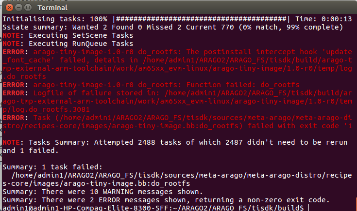

  • Hi Karthik,
    I followed the instructions as per above link ,got some warnings during the build process but successfully able to build minimal target filesystem.
    Build output is generated in ARAGO/ARAGO_FS/tisdk/build/arago-tmp-external-arm-toolchain/deploy/images/am65xx-evm.
    But while booting in EVM  I am facing below issue...

    NOW THE ACTUAL PROBLEM, where we need to enable FTP service in Tiny filesystem . For this made some modifications in the source .
    ARAGO/ARAGO_FS/tisdk/sources/meta-arago/mrta-arago-distro/recipes-core/images $gvim arago-tiny-image.bb
    # Install a small set of utils which can be used for diagnostics
    # ARAGO_TINY_IMAGE_EXTRA_INSTALL ?= "parted util-linux e2fsprogs dosfstools devmem2"     Comment  the existing
    ARAGO_TINY_IMAGE_EXTRA_INSTALL += " \
            dropbear \
            openssh-sftp-server \
            netkit-ftp \
    - cleaned and recompile the source
    MACHINE=am65xx-evm bitbake arago-tiny-image -c cleansstate
    During the re-compilation got some errors(attached for reference)
    Am I missing any configurations?
    regards
    Venkatesh
  • Hi Venkatesh,
    I have reviewed your steps and everything looks good except your step #4.
    1. I would not comment out what is existing there already, instead we should just add the packages that we need additionally. Quickly tried this on my side and it works well.
    2. You can simply run the bitbake command directly, there is no need to do a cleansstate. It worked for me without that.
    Changes that I made:
    ARAGO_TINY_IMAGE_EXTRA_INSTALL ?= " \
            parted \
            util-linux \
            e2fsprogs \
            dosfstools \
            devmem2 \
            arago-feed-config \
            dropbear \
            netkit-ftp \
    Karthik
  • I don't know why unable to see your reply in the forum ..
    Hi Venkatesh,
            parted \
            util-linux \
            e2fsprogs \
            dosfstools \
            devmem2 \
            arago-feed-config \
            dropbear \
            netkit-ftp \
    I tried with your suggestion above got 4 errors
  • Hi Venkatesh,
    In order to help you with this, I have recreated the entire sceanrio and giving you the history of my command line - you can use this as the cheat sheet to figure out what is going on at your end. These have been tried on Ubuntu 18.04.
    mkdir am65xx-6.00-tiny
    cd am65xx-6.00-tiny/
    git clone git://arago-project.org/git/projects/oe-layersetup.git tisdk
    cd tisdk/
    ./oe-layertool-setup.sh -f configs/processor-sdk/processor-sdk-06.00.00.07-config.txt
    cd build/
    . conf/setenv
    TOOLCHAIN_BASE=/sdk/tools MACHINE=am65xx-evm bitbake -k arago-tiny-image
    tar tf arago-tmp-external-arm-toolchain/deploy/images/am65xx-evm/arago-tiny-image-am65xx-evm.tar.xz  | grep dropbear
    #The above will not give you any results
    Next edit the file to add the dropbear and FTP, patch is below
    cd ../sources/meta-arago/
    vi meta-arago-distro/recipes-core/images/arago-tiny-image.bb
    Patch is here:
    diff --git a/meta-arago-distro/recipes-core/images/arago-tiny-image.bb b/meta-arago-distro/recipes-core/images/arago-tiny-image.bb
    index 56e94293..fe3f4efe 100644
    --- a/meta-arago-distro/recipes-core/images/arago-tiny-image.bb
    +++ b/meta-arago-distro/recipes-core/images/arago-tiny-image.bb
    @@ -16,6 +16,8 @@ ARAGO_TINY_IMAGE_EXTRA_INSTALL ?= "parted util-linux e2fsprogs dosfstools devmem
    IMAGE_INSTALL += " \
    packagegroup-arago-sysvinit-boot \
    ${ARAGO_TINY_IMAGE_EXTRA_INSTALL} \
    + dropbear \
    + openssh-sftp-server \
    export IMAGE_BASENAME = "arago-tiny-image"
    After this, simply run the build by following the below commands:
    cd -
    #You will see your utilities available here
    Karthik
