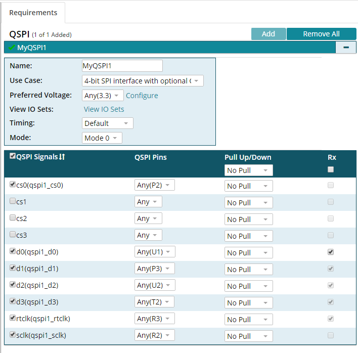

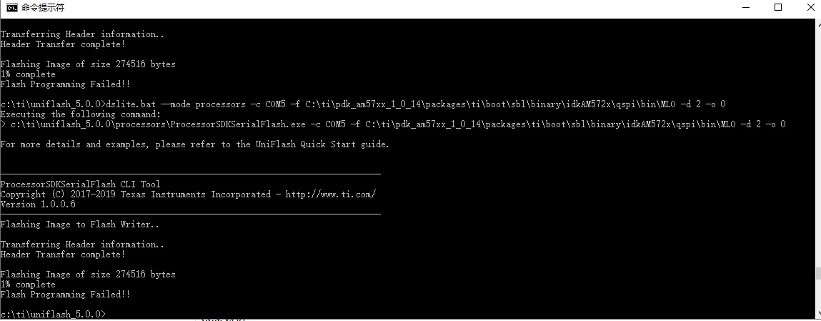

AM5728: am5728 flash_writer write qspi 1% complete,Flash Programming Failed!!
Part Number: AM5728

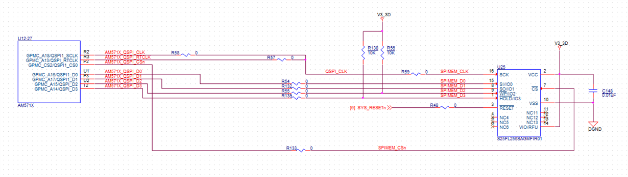

<<Environment>>
Host PC: Windows10 64bit
Target: custom board reference idkAM5728
SDK: processor_sdk_rtos_am57xx_5_03_00_07
PDK: pdk_am57xx_1_0_14
CCS: v8.0
Uniflash:  5.0.0
ccs load C:\ti\pdk_am57xx_1_0_14\packages\ti\board\utils\uniflash\bin\idkAM572x\uart_idkAM572x_flash_programmer.out,uart5 print "ccccc",

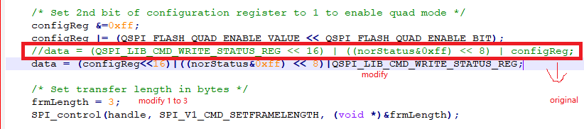

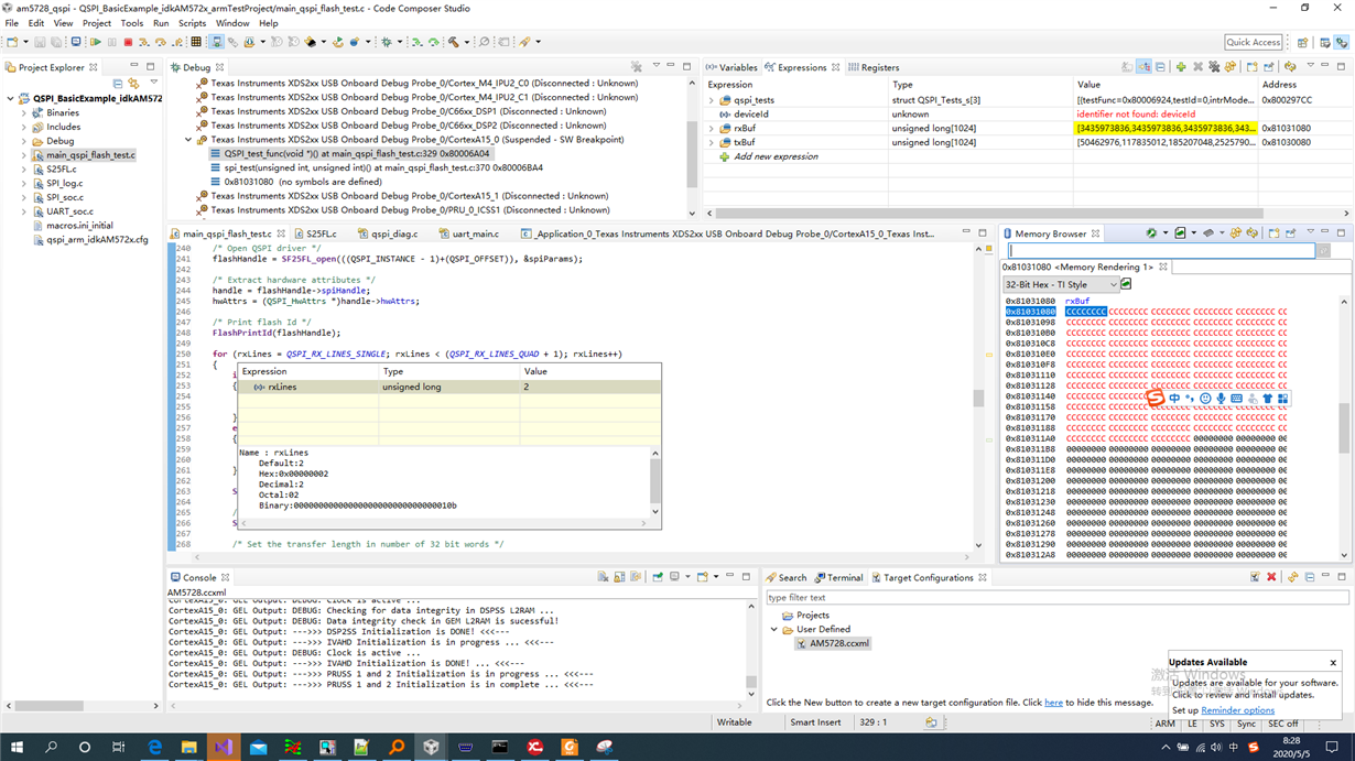

and I test C:\ti\pdk_am57xx_1_0_14\packages\MyExampleProjects\QSPI_BasicExample_idkAM572x_armTestProject
at cfg mode signal and dual no problem but at quad read back cccc,I suspect that the problem here causes flash program fail.
