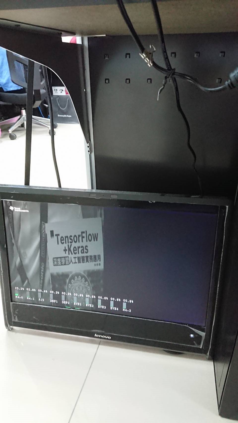

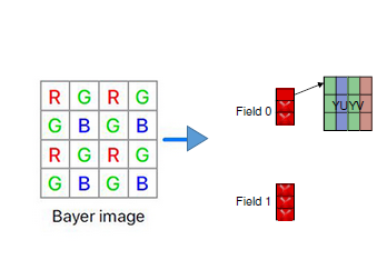

    I have configured successfully the APTINA sensor (AR0144)  via I2C1 interface, and access the Chipset ID.
    Due to the sensor output  as 10-bits Bayer raw image (Monochrome),
    the usercase of vip_single_cam_opencvcanny  just display one half of image on HDMI panel.
    As for the ChainsCommon_SetVidSensor() function, I configured:
         pPrm->standard       = SYSTEM_STD_720P_60;
        pPrm->dataformat    = SYSTEM_DF_BAYER_GRBG;
        pPrm->videoIfWidth  = SYSTEM_VIFW_10BIT;
        pPrm->fps                  = SYSTEM_FPS_60;
        pPrm->numChan      = numCh;
        pPrm->isLVDSCaptMode = FALSE;
    It seems that there is some problem in format mismatch between vpscore and capture (VIP).
    Could you help teach me how to solve the display issue ?

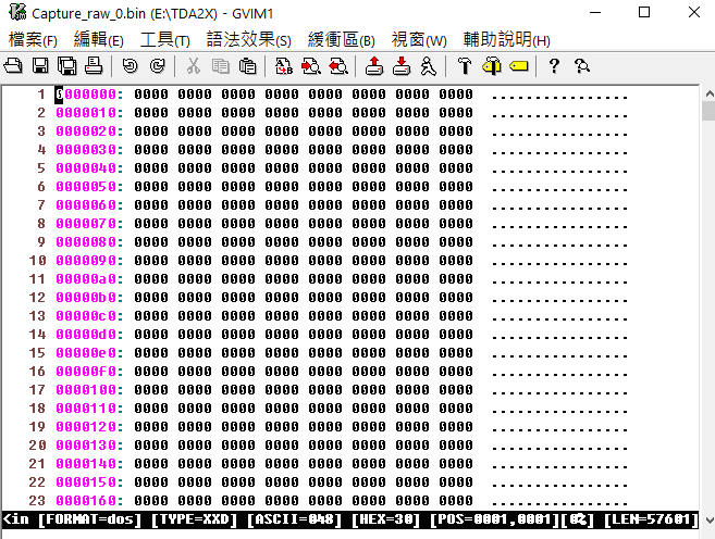

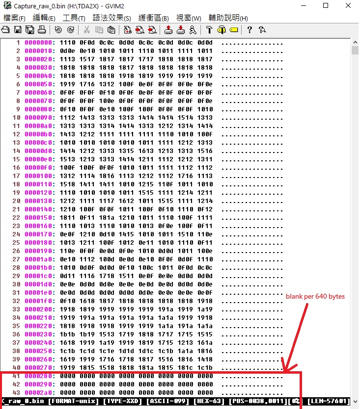

  • Hi Sam,
    Great, good to know that you are now able to access AR0144 and also able to capture the data.
    I would first suggest to dump one capture frame and check if the received frame is correct and is as expected in terms of frame size.
    Frame/Buffer size is typically same for YUV422 and 10bit bayer data.. display should be able to display atleast full screen, although quality may not be good.
    Brijesh

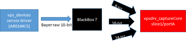

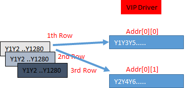

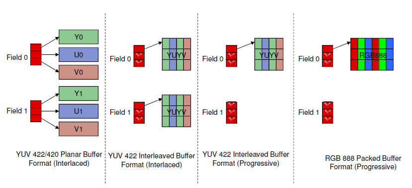

  • Hi Brijesh,
    Thank you for your suggestion.
    As I try to configure the format of (FVID2 &sensor driver)
    FVID2_DF_YUV422I_UYVY = 0x0000,         /**< YUV 422 Interleaved format - UYVY. */
    FVID2_DF_YUV422SP_UV
    FVID2_DF_YUV422P
    It just display a half of image on the screen.
    I guess that the format should be for the color space image,
    the monochrome/gray image should be Y planar only without U and V (chrominance; color).
    It means that FVID2 should handle the image data with a special method.
    Could you help teach me how to validate the data whether if it be correct for each Link (Capture, Alg_link, Display)?
    BRs,
    Sam.
  • Hi Sam,
    As i said, format is correct. Since VIP is a video port, we are just configuring it to capture 10bit data as if it is YUV422 and store it in 16bit container. So this is fine.
    Fvid2 cannot handle/convert the data format, This needs to be done by one of the HW module. But monochrome data could be processed in DSP only.
    If you just directly connect it to display, display will just it as if it is YUV422. But even in this case, height should not be half.
    This is why i was suggesting, can you try dumping a frame from the capture and analyze it offline?
    Brijesh

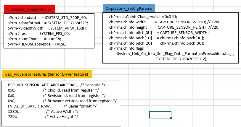

  • Hi Brijesh,
    Thank you for your comment.
    I confirmed that the input/output dataformat (In/Out: SYSTEM_DF_YUV422P, SYSTEM_DF_YUV420SP_UV) of CaptureLink is correct
    which as configured at ChainsCommon_SingleCam_SetCapturePrms().
    [IPU1-0]     11.415970 s: CaptureLink_drvProcessData: CAPTURE(0): (numFrame=1, infmt=0x6, outfmt=0x7)!!!
    [HOST  ]     11.416305 s: AlgorithmLink_opencvCannyProcess: Input format=0x0, pitch=0x500, Output format=0x7, pitch[0..1]=0x500 0x500
    But the dataformat of AlgorithmLink_opencvCannyProcess() isn't as expected.
    It seems that there is a problem in data format mismatch,
    Does it be the same data format (SYSTEM_DF_YUV420SP_UV ) during Algorithmlink?
    BTW, the height of image is correct, the width of image is half of sensor output.
    I understood that the function is created by AlgorithmLink_pluginCreate(),
    I don't know how to pass the created parameter from Utils_msgGetPrm(pMsg)
    Could you help instruct me how to pass the of pCreateParams to AlgorithmLink_opencvCannyCreate( ) function? Thanks.
    I observed that the Alg_OpenCVCannyProcess() function handle the wordwidth on the dataformat.
     if(dataFormat == SYSTEM_DF_YUV422I_YUYV)
            numPlanes = 1;
            wordWidth = (width*2)>>2;
        else if(dataFormat == SYSTEM_DF_YUV420SP_UV)
            numPlanes = 2;
            wordWidth = (width)>>2;
    BRs.
    Sam Hsieh

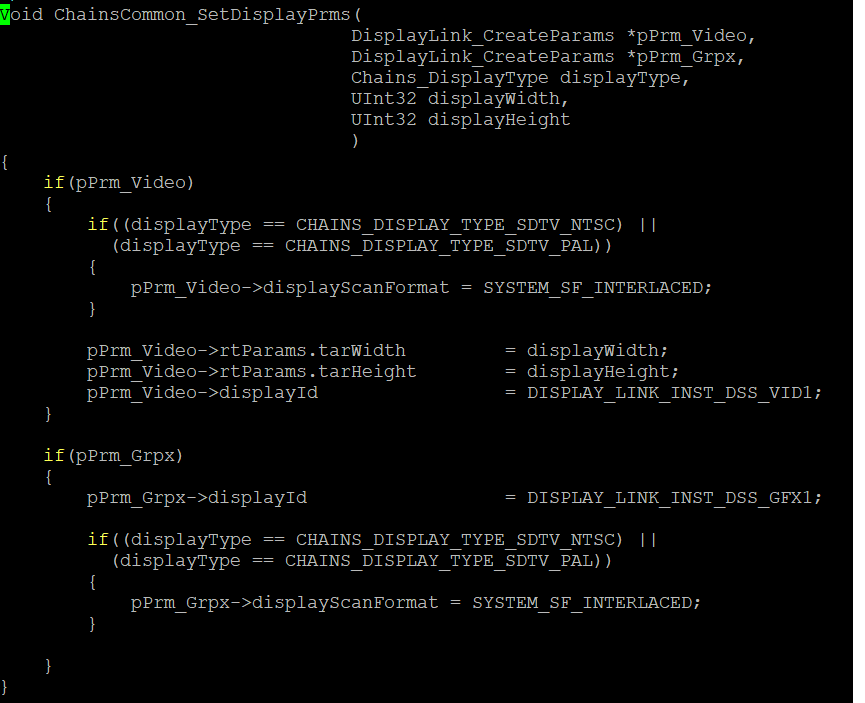

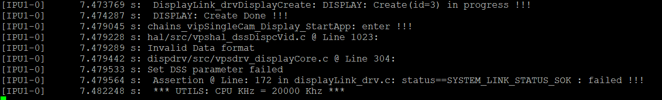

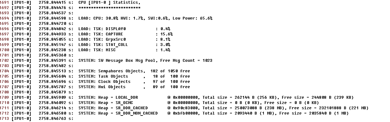

  • Hi Brijesh,
    I ran the usecase of "vip_single_cam_view", it just displayed green screen without no image data.
    I confirmed that both the CaptureLink and DisplayLink called drvprocessdata() function when receive an  SYSTEM_CMD_NEW_DATA command.
    and the following statistics also work fine.
    but I observed that a surprising phenomenon:
    both the pVideoFrame->chInfo.width, pVideoFrame->chInfo.height are zero on the DisplayLink when ran the usecase of vip_single_cam_view .
    the pVideoFrame->chInfo.width(0x500) , pVideoFrame->chInfo.height (0x2d0) are ok on the DisplayLink when ran the usecase of opencanny.
    I am not sure whether if it is related to the output format (isChInfoChangeValid flag)?
    BRs,
    Sam Hsieh.
    I filled  into U plane with 0x80 (pFrame->addr[0][1]) when CaptureLink handle captured data.
    It could display a half of grey screen, the issue of green screen is gone.
    but I don't understood clearly how to xfer the field0/field1 frame from Capturelink to DisplayLink.
    Could you teach me how to fix the issue of a half of screen ? Thanks.
    ps. usecase: vip_single_cam_view
    BRs,
    Sam Hsieh
  • Hi Sam,
    Field is required only for interlaced capture. Most of the cameras uses progressive mode. So no need to worry about fields.
    Brijesh

    As the function of ChainsCommon_SingleCam_SetCapturePrms() configured the captureInWidth=1280, captureInHeight=720,
    and the ChainsCommon_SetDisplayPrms().
    But it still just display one-half image on screen as the attached.
    it seems that there are a half frame data be truncated during VIP parsing frame.
    Could you help explain how to parse the raw monochrome image frame from sensor output via parallel interface?
    BRs,
    Sam.

  • And how is it stored in memory? is it stored in 16bit container in unpacked format?
    Can you save capture output and view it offline in some hex viewer and check if the data is 10bit or 8bit? also is the full line captured in the buffer?
    Can you also check if the pitch/line-offset provided to the driver is correct?
    Rgds,
    Brijesh

    BTW, as the function of vpsDrvCaptGetVipCoreSrcId() in file:
    .ti_components/drivers/pdk_01_10_03_07/packages/ti/drv/vps/src/vpsdrv/captdrv/src/vpsdrv_captureCore.c
    Which described the slice1 PortA  just support FVID2_VIFW_8BIT/ FVID2_VIFW_16BIT/ FVID2_VIFW_16BIT (instObj->createPrms.videoIfWidth).
    It seems that there is a trick to convert the sensor format (from Bayer raw 10-bit to 16-bit in the VIP handling) then parsing Y frame.
    I'm a bit confused at the videoIfWidth & data format.
    Could you help teach me how to identify the createPrms.videoIfWidth for  sensorConfig or display data-format? Thanks.
    BRs,
    Sam Hsieh
  • Sam,
    Video Interface width (videoIfWidth) provides the interface size, ie 8bit, 16bit or 24bits. whereas dataformat provides format of the data ie YUV/RGB etc.. Both are different settings..
    What is black box in the above image? Do you have anyother module between sensor and VIP?
    Rgds,
    Brijesh
  • Hi Brijesh,
    I stored the captured frame (frame->addr[0][0]) into SD card via the API:
    ChainsCommon_Osal_fileWrite( fp, (UInt8*)ChainsCommon_Osal_getVirtAddr( (UInt32)Plane_bufaddr), frame_size);
    but the content is wrong (0x00).
    At the same time, I observed that the following error message: does it related to the wrong frame ?
    BRs,
    Sam Hsieh.
  • Hi Sam,
    The error is correct, since you are using RAW10 bit input, the interface size cannot be 8bit, so driver defaulting to 16bit..
    Does display still display half correct frame? If this is the case, then dumped file is not correct.
    Do you have JTAG connectivity?
    Rgds,
    Brijesh

    It observed that the input data format is 0x1e during DisplayLink handled (In DisplayLink_drvProcessData()).
    The Mono sensor just output 10-bit raw Y image data (W/O UV) on the TDA2X board,
    how VIP store data in the frame->addr[0][0] and frame->addr[0][1]) or all Y frames stored in addr[0][0] buffer?
    Is it like as the following :
    BTW, we reserved  a JTAG interface on TDA2X board for connect CSS.
    There are no other module between SENSOR and VIP board.
    BRs,
    Sam Hsieh
  • Hi Sam,
    In this case, VIP stores data only using addr[0][0] memory.

    Can you share frame size and data format for both VIP and DSS?
    Rgds,
    Brijesh
  • Hi Brijesh,
    I observed that the GRPX link is initiated & work fine
    at the same time, the chains_vipSingleCam_Display_SetAppPrms() configured the dataFormat of GrpxSec.
    pUcObj->GrpxSrcPrm.grpxBufInfo.dataFormat = SYSTEM_DF_BGRA16_4444;
    displayType = CHAINS_DISPLAY_TYPE_HDMI_1080P
    but the VIP configuration:
     pObj->captureOutWidth=1280,
     pObj->captureOutHeight=720;
     pInstPrm->videoIfWidth  =   SYSTEM_VIFW_16BIT;
     pInprms->dataFormat =   SYSTEM_DF_YUV422P;
    regards,
    Sam Hsieh
  • ok, can you also please share display parameters?
  • Hi Brijesh,
    The display as following:
  • Hi Brijesh,
    Here are my configuration of  the vip_single_cam_view.
    BTW, the AR0144CS sensor could output 12-bit/10-bit data via parallel interface. defaults 12-bits (control by 0x31AC Reg.)
    Could you help review which Params could result in the issue? Thanks.
  • Hi Sam,
    Can you try changing display format to also YUV422 and pitch to 2 times width? How doe it look in this case?
    I see format mismatch between capture and display, I am not sure if the half screen issue is due to format mismatch.. But can you make them same and check the output?
    Brijesh
  • Hi Brijesh,
    I tried to update the display format to YUV422 & 2 times width (YUV422P) which results in the assertion error,
    and it occurred the issue of upper half black screen and on the bottom half green screen when configured YUV422SP_UV.
    BRs,
    Sam Hsieh
  • Sam,
    Display supports only UYVY and YUYV YUV422 formats, can you please check if you have set it correctly?
    Rgds,
    Brijesh

    I don't know why it could captured sensor raw image frame and display a-half image of screen  when VIP (slice1A port) configured the videoIfWidth as 8-bit,
    but it couldn't when configured 16-bits, and the all captured frame data are "0x00".
    At the same time, it captured a frame which the size is 0xe1000 (921,600= 1280*720),  there are 640 bytes data, 640 bytes empty per SYNC.
  • Hi Sam,
    I am bit confused.
    Since your input is 10bit data, you cannot use 8bit interface. 8bit will just capture upper or lower 8bits and since the number of clock cycles remain same for 8bit, it will become half..
    Please use 16bit input interface. What do you see for 16bit interface? Does it capture full frame?
    rgds,
    Brijesh
