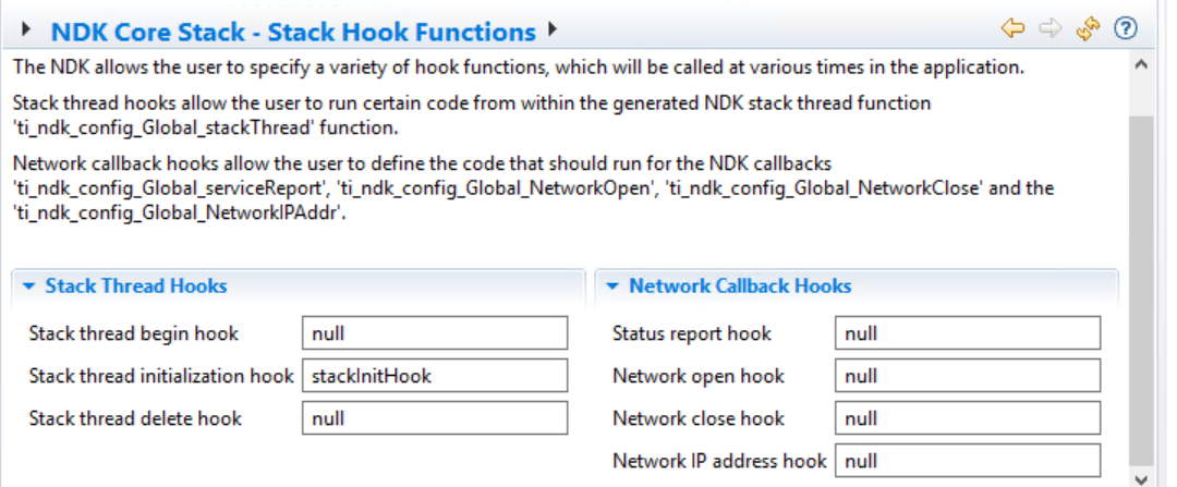

    Have you tried to add a hook function to get stack initialization status? You may also refer to section 4.4 Initialization Procedure in NDK API reference guide (SPRU524K).

  • Hello Garrett,
    I can add a stackInitHook function.  Any suggestions on what I can call/add within that function to verify a viable network?

    See the NDK initialization procedure:
    6. Boot the stack with the configuration by calling NC_NetStart( hCfg, pfnStart, pfnStop, pfnNetIP ) with a
    handle to the configuration, plus pointers to the three generated functions for start, stop, and IP
    address change operations. The NC_NetStart() function does not return until the stack session has
    terminated.
    7. After some preliminary initialization, the NC_NetStart() function creates a new thread that calls the
    generated NetworkOpen() function.
    8. Run the Network Open (Global.networkOpenHook) hook function if one is configured.
    9. The NetworkOpen() function creates task threads for its networking requirements.
    So you can add a network ready status flag in the 'Network open hook' which associates to NetworkOpen() funciton, then start your application if the flag is set.

  • Thanks Garrett.  I believe this answers my question.
