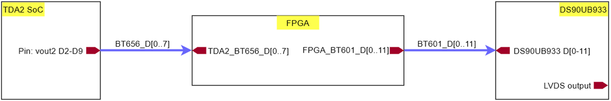

The output dataflow:

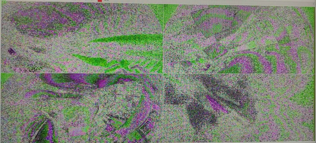

I used a device in the remote side to deserilize the video data and show images in the screen. But it's now looks like below. The curve can be seen while the color looks messy.
Please help me with how to debug this problem. Anything else needed, let me know!
