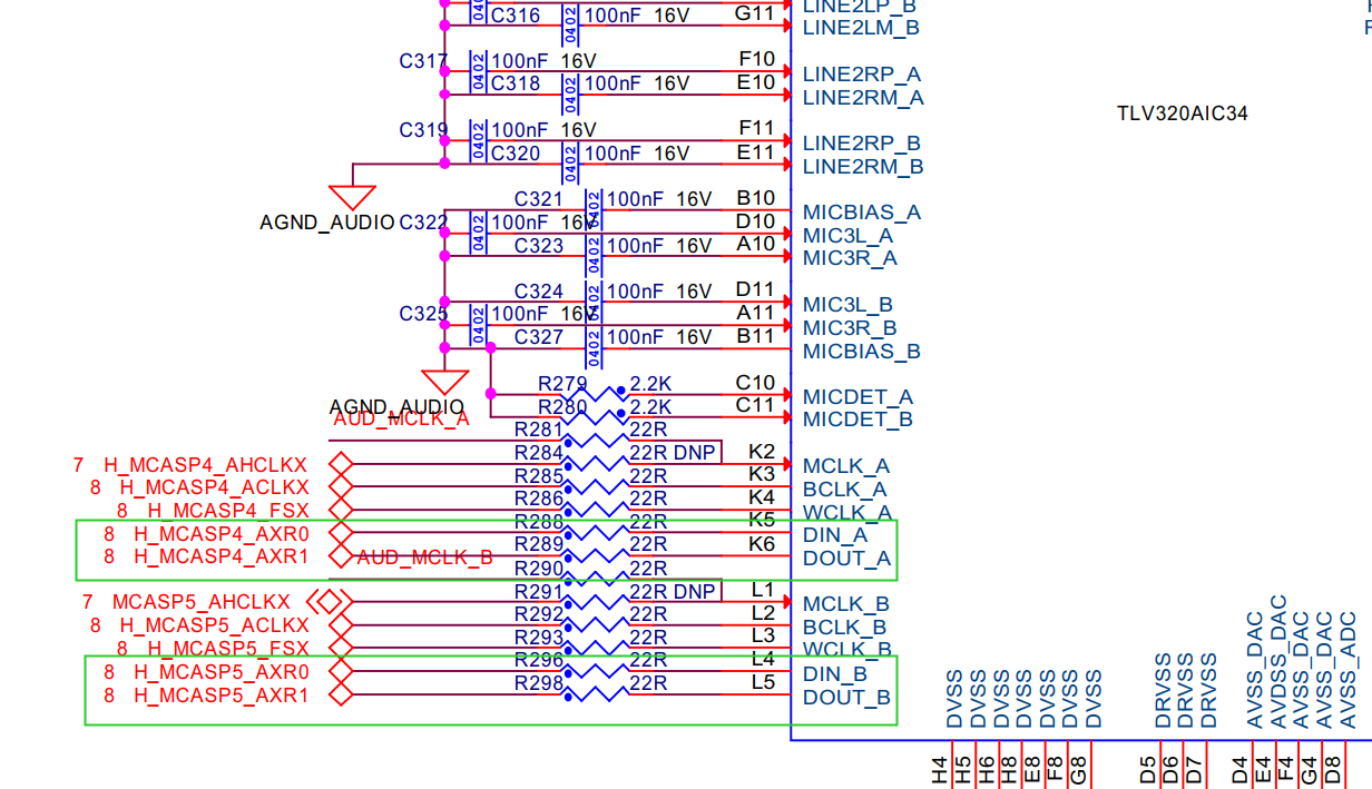

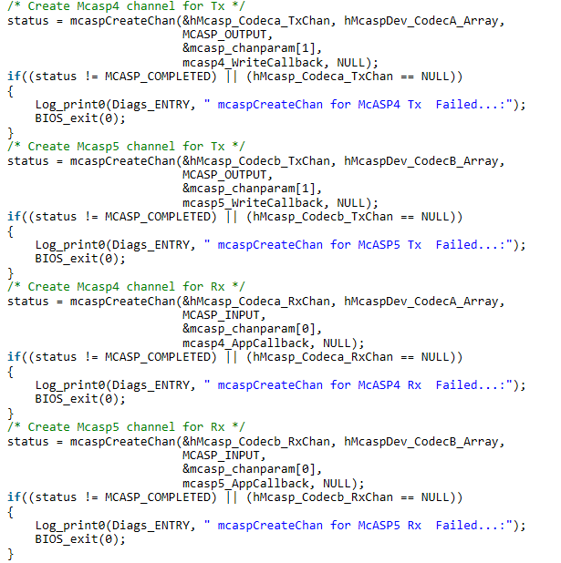

In Create_Stream, mcaspCreateChan created Mcasp channel 4 both TX and RX .

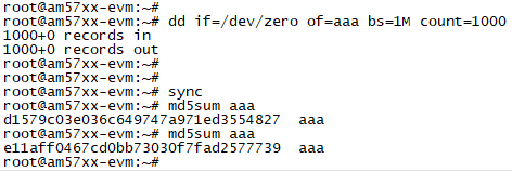

Creating a 1G file aaa, then running below commands on the board.
cp aaa bbb
sync
diff aaa bbb
aaa is different from bbb.

    Part of the code is as follows.

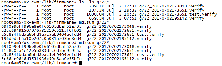

  • Check MD5 like this,
    md5sum is changed.

    2. In later post it seems you first create TX chan on McASP4 and McASP5, then create RX channel on them again. Can you confirm which serializer pins of each McASP that you used for TX / RX?
