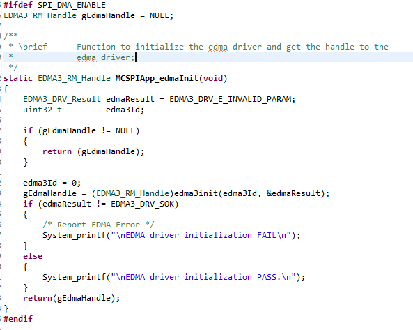

I attempted to upgrade the communication, so that it uses DMA. Therefore, I have noticed that all of the functions of SPI driver have a corresponding calls to functions in case DMA is enabled. I have found the definitions of SPI configuration and transfer using DMA in the C:\ti\pdk_c665x_2_0_15\packages\ti\drv\spi\soc\dma\v0 directory inside the file SPI_dma.c, and also used main_mcspi_test.c, found in C:\ti\pdk_c665x_2_0_15\packages\ti\drv\spi\test\src as reference. Additionally I have imported several files from C:\ti\edma3_lld_2_12_05_30E\packages\ti\sdo\edma3\drv\sample  and  C:\ti\edma3_lld_2_12_05_30E\packages\ti\sdo\edma3\rm\sample, as they contained several function definitions needed for the building of code. Finally, I was able to build the code without the error, but when I try executing it, the EDMA Iinitialization returns PASS, but the transfer is failed due to TIMEOUT error. While debugging, I noticed that functions for dma interrupts are not being called at all, therefore I thought that maybe I have a mistake in SPI configuration.
Am I initializing SPI and DMA correctly?

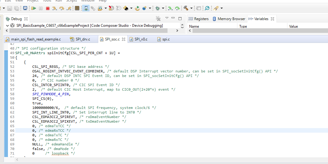

Parameters of SPI configuration structure:
Here is what I change from the parameters of SPI configuration structure:
And here is the function for EDMA init:
Here are all of the files imported in the project:
I will appreciate any help or comment. If needed, I can attach any of the files that I use.
Here is the main file:

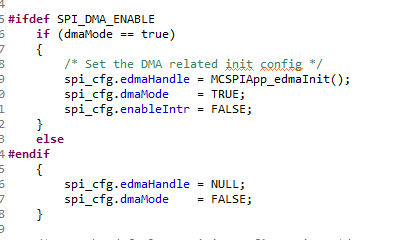

#ifdef SPI_DMA_ENABLE
    if (dmaMode == true)
        /* Set the DMA related init config */
        spi_cfg.edmaHandle = MCSPIApp_edmaInit();
        spi_cfg.dmaMode    = TRUE;
        spi_cfg.enableIntr = FALSE;
    else
#endif
        spi_cfg.edmaHandle = NULL;
        spi_cfg.dmaMode    = FALSE;
    /* Set the default SPI init configurations */
    SPI_socSetInitCfg(0, &spi_cfg);
EDMA3_RM_Handle gEdmaHandle = NULL;
 * \brief      Function to initialize the edma driver and get the handle to the
 *             edma driver;
static EDMA3_RM_Handle MCSPIApp_edmaInit(void)
    EDMA3_DRV_Result edmaResult = EDMA3_DRV_E_INVALID_PARAM;
    uint32_t         edma3Id;
    if (gEdmaHandle != NULL)
        return (gEdmaHandle);
    edma3Id = 0;
    gEdmaHandle = (EDMA3_RM_Handle)edma3init(edma3Id, &edmaResult);
    if (edmaResult != EDMA3_DRV_SOK)
        /* Report EDMA Error */
        System_printf("\nEDMA driver initialization FAIL\n");
    else
        System_printf("\nEDMA driver initialization PASS.\n");
    return(gEdmaHandle);
#endif

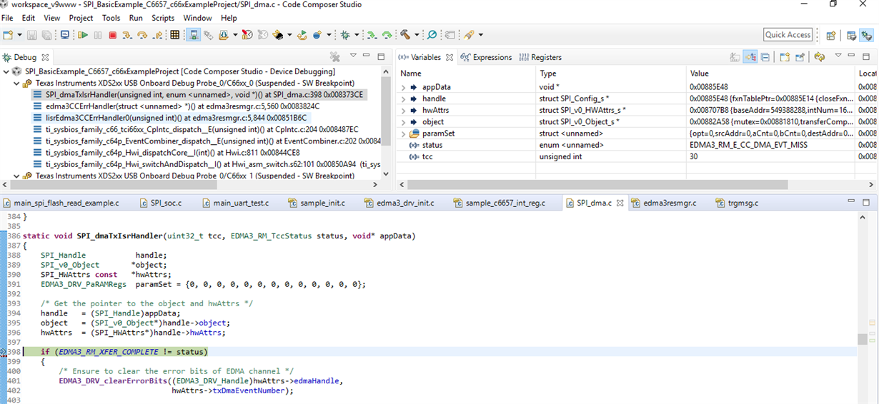

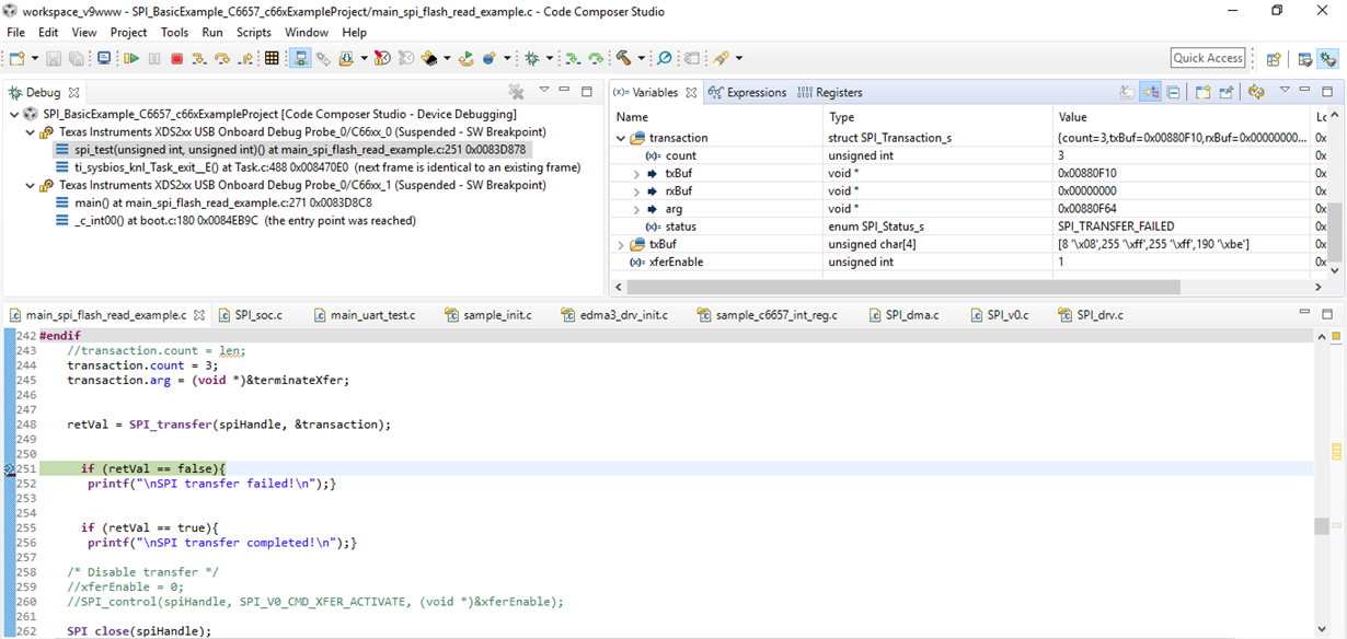

    Now SPI transfer function returns retVal = 1, but when I look at the status values of transaction variable it says SPI_TRANSFER_FAILED. When I put breakpoints inside interrupt handler functions for Rx and Tx, I see that for Tx once the status is that transfer was missed and another time that it is completed. For Rx it is always transfer completed, but there are no values in the rxBuf after the transaction.
    On the scope I can see the SPI SCL,K as well as CS, and a slight glich on MOSI, but nothing on MISO.
    Breakpoint in the TX interrupt handler function (in the next breakpoint the status is not missed, but completed):
    Breakpoint in the RX interrupt handler function (always complete):
    When I return from SPI_transfer function, the variables look like this:
    And here is how SPI CLK and CS look like:
    I am attaching my project, I would very much appreciate it if you could take a look and let me know what you think how can I solve it.
