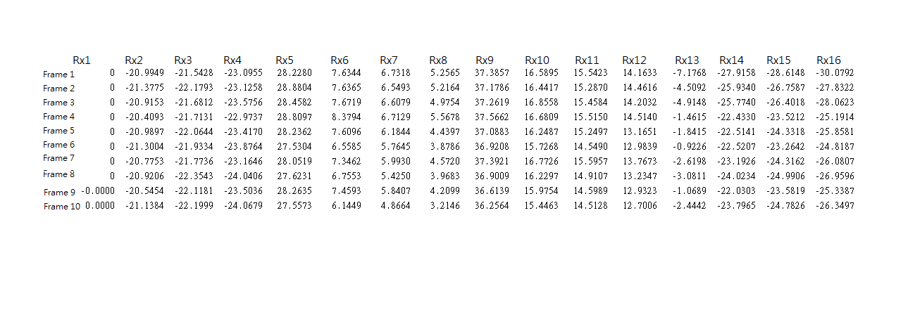

    I try to calibrate the phase difference between the Rx at the beamforming mode.
    I put a corner reflector at 0 degree and on the static distance, and I measure the phase difference between each Rx for 10 frames.
    Then, i found the phase difference of each frame are different.
    According to my acknowledge, I think the phase difference between each Rx should be static if the corner reflector is on the static position.
    The result is shown below.
    Thanks.
    Morris

  • Hi Morris,
    Can you please show me the phase stability over each chirp. What does that trend look like inside of a given frame? I agree, the assumption is that the phase delta should be pretty stable between frames. Some drift is expected depending on how much the temperature varies over time.
    Is the ambient temperature being controlled in any way? Is this an indoor or an outdoor measurement?
    Would it be possible for you to repeat this experiment in mmWave Studio using the TX-BF example project, comparing against the ProcessorsSDK code?
    Thank you,
    -Randy
  • Hi, Randy
    I try to measure the RXs phase for 1T16R, and the result is okay (<3 degree)(as shown as figure 1).
    I think the phase error is caused by TX beamforming in the demo.
    Can you have any advice?
    Thanks.
    Morris
    figure 1.
