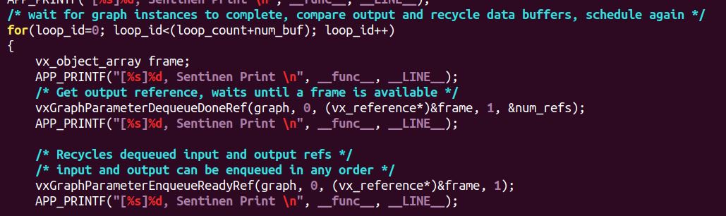

  • Hi Brijesh:
    Sorry to brother you.
    I try to modify test_capture_display.c for capture form DS90UB926 pattern.
    But I find in Capture Initlization define(tivx_capture_inst_parameters_t)
    It seem "tivx_capture_inst_parameters_t" is used for Deserializer who supported CSI data bus.
    If I want to ceate a capture node for DS90UB926,
    How can I define this part?
    or I need another structure for DS90UB926?
    BR
    Sentinen Chen

  • Hi Brijesh:
    Yes, if I didn't study wrong file,
    I think test_capture_display.c will use appImx390Config function in vision_apps/utils/sensors/src/app_sensors.c
    and it just do four things through I2C Bus in this function
    Configure UB960 -> Configure UB953 -> Configure IMX390 --> Enable UB960 CSI port
    Because I want to test UB926, I mark origin part code of four things , and re-build vision_apps first.
    and then I follow below steps under linux to test:
    1. Init vision_apps
    # cd /opt/vision_apps
    # ./vision_apps_init.sh
    2. Pull High pca6408 Pin2 & Enable UB926 default internal timing pattern generate (follow snla132e.pdf)
    # i2cset -f -y 5 0x20 0x3 0xfa
    # i2cset -f -y 5 0x20 0x1 0xff
    # i2cset -f -y 5 0x2c 0x65 0x03
    # i2cset -f -y 5 0x2c 0x64 0x31
    3. Run the re-build testcase
    # ./vx_app_conformance.out --filter=tivxHwaCaptureDisplay.CaptureDisplayLoopback1
    Right now my testcase will wait-lock on vxGraphParameterDequeueDoneRef function.
    This is why I start to doubt capture parameters.
    Do your have any suggestions?
    BR
    Sentinen Chen

  • Hi Brijesh:
    I think I am into a misunderstanding.
    After check TRM again,
    I find MsASP is a audio interface, not video interface.
    so there is no capture frame form UB926 when I enable UB926 gerenated pattern is a normal situation.
    Please ignore my last questions,
    Thanks a lot!!!
    BR
