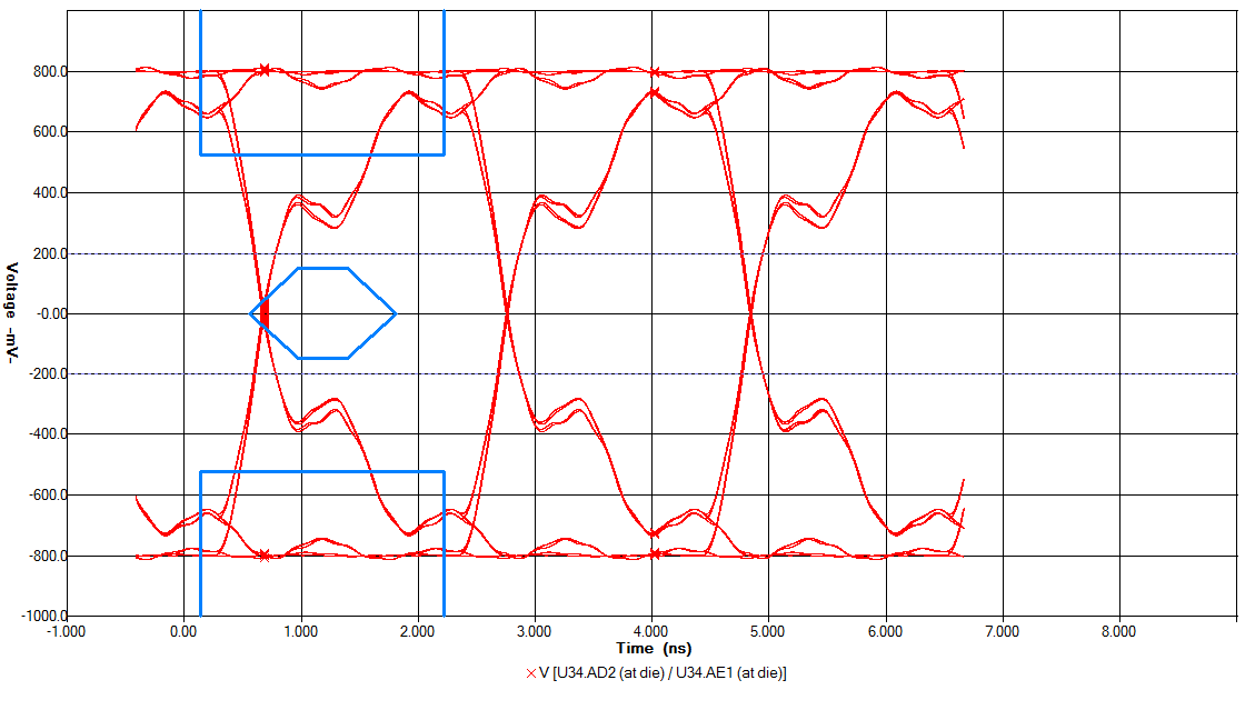

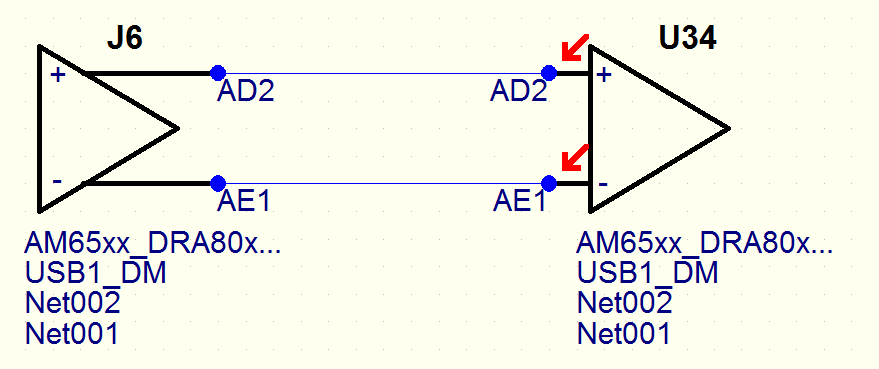

I was performing Signal integrity analysis for USB 2.0 interface considering AM6546 as driver.
Even if we simulate the Signal integrity in Zero transmission path(just by considering driver and receiver), we are observing the eye is not meeting the required parameters, attaching the file for your reference.
Image of Zero transmission path.
Wave forms
Also, for USB 3.1 we are noticing that there are no buffer models present in IBIS models.
Please let us know how to proceed further and over come these issues.

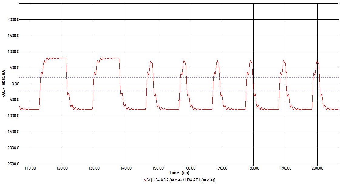

    We ran a quick check using Hyperlynx.  With the TX model configured as HSDP_TX and the RX model using FSRX we see a reasonable waveform.
    Can you try that?  Also, can you share a basic waveform (~10 cycles) in addition to an eye diagram?

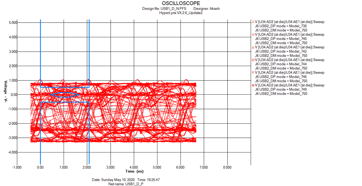

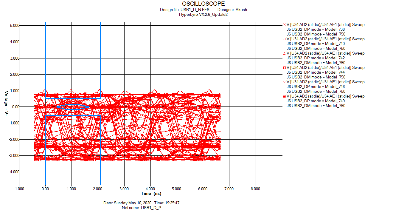

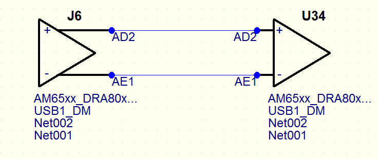

    We had tried as per above mentioned configuration earlier and below were the results.
    Waveform is still exceeding the standard specified mask details.
    Schematic.
    Eye Diagram,
    Standard waveform,
    Also, please let us know which encoding technique was used while simulating at your end.

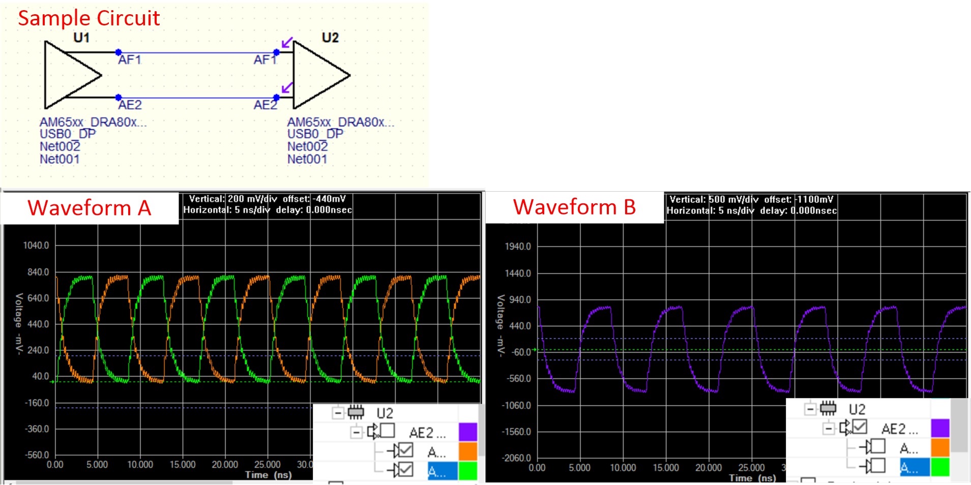

  • I have create a simple Hyperlynx simulation with the AM65 IBIS model, and the USB differential input/outputs (as shown in customer's previous communication).
    Below is my sample circuit.  When looking at the signals themselves (Waveform A), you see the signals oscillate from 0v to 0.8v, as expected for HS USB driver.  However, when looking at the differential receiver (Waveform B), you see the signal oscillates +/-0.8V.  Again - this is an interpreted waveform (difference), not actually seen on the PCB.  If customer is looking at an eye diagram, they should use the signals themselves (as seen on the PCB), not the interpreted waveform generated by the differential receiver.
