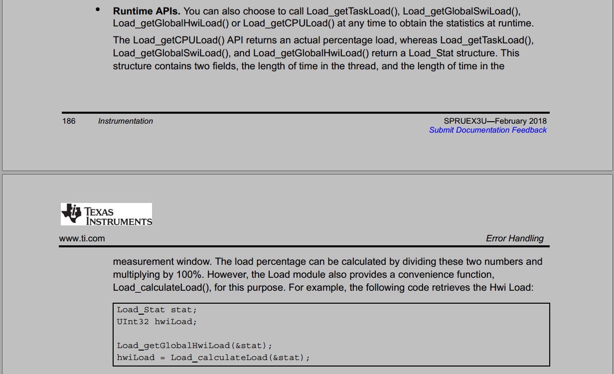

Now in my project,I want to calculate the CPU load,Hwi load,task load and so on.So I refered to the SYS/BIOS manual,I found that the API functions in the module Load of SYS/BIOS.But the manual only say that I can use the runtime API,as the screenshot I post,and I don't how to use the API in my project.Would you show me how to use the runtime APIs of the Load? Are there some demos?
The SYS/BIOS I used is bios_6_75_02_00.
Than you!
    There is detailed documentation available for the Load module here: <BIOS>/docs/cdoc/ti/sysbios/utils/Load.html.
    I'm unaware of any AM335x examples (SYS/BIOS or PDK) which use Load module functions.
    Frank
