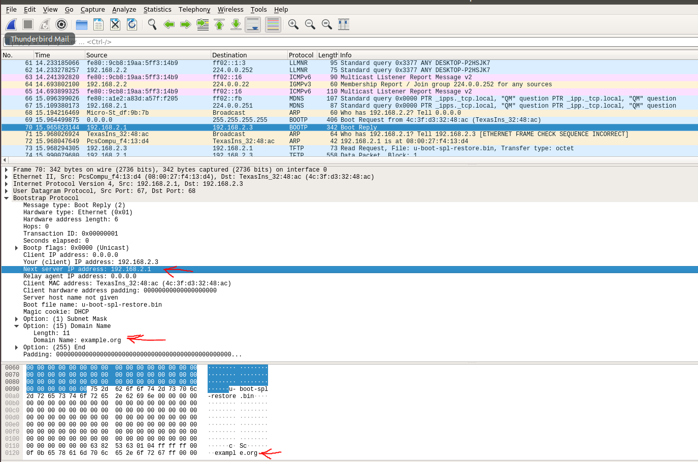

  • Andreas,

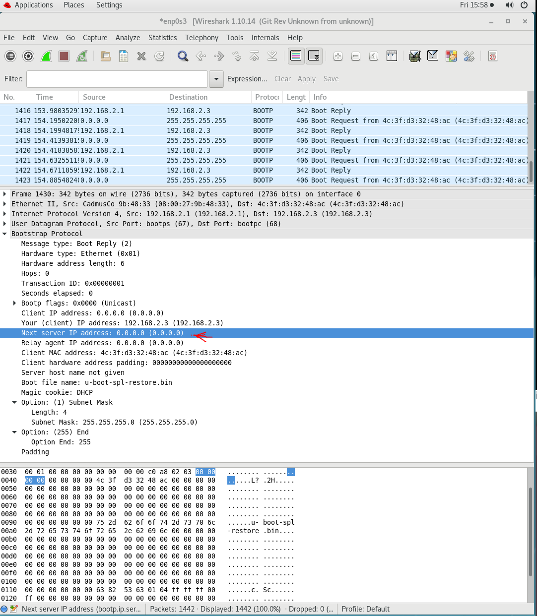

    I think you're right. After comparing the BOOTP reply between Ubuntu and Red hat. They are not exactly the same. The discrepancies are as belows:
    1) Ubuntu sends BOOTP with "Next server IP address: 192.168.2.1" which is my host IP
    2) The option domain-name is just an example written on the dhcpd.conf file.
    RED HAT BOOTP REPLY

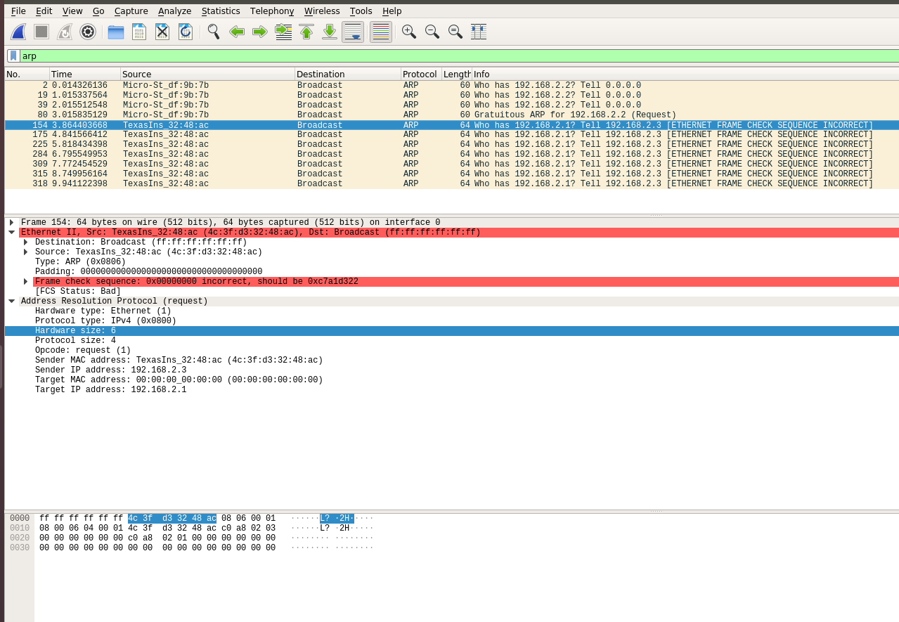

    UBUNTU BOOTP REPLY and ARP who-has and ARP reply following after that.

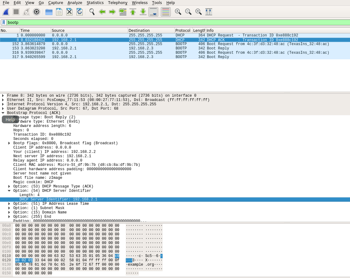

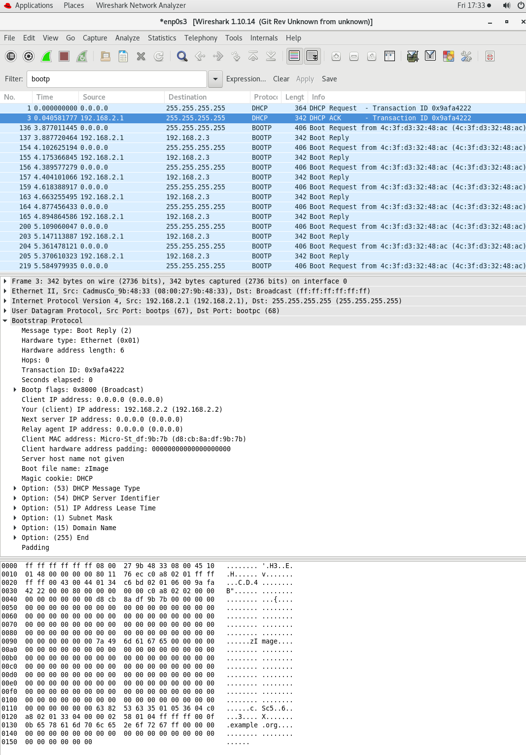

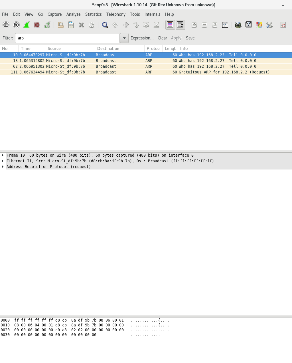

    As crazy as it sounds, I also did a test to compare the difference between Red hat and Ubuntu when both of them OFFLINE (Disconnect the network), though I'm not sure it could help anything. So, without any connection, the BBB still recognize the the server host to send and ARP who-has to the host on Ubuntu, but not on Red hat.  Red hat still miss the "Next Server IP address"
    UBUNTU: DISCONNECT NETWORK BOOTP & ARP
    REDHAT: OFFLINE BOOTP & ARP

  • updated: Thank you Andreas for your suggestion. I add the next-server 192.168.2.1 to the DHCP network configuration so that the BBB can find the the this IP specifically and ti worked.
    I'm not sure this is the perfect solution or not, but it seems to work so far. Please let me know if you have any better suggestion. For example, the BBB can still know what is the IP of the host (redhat) no matter what IP it is.
