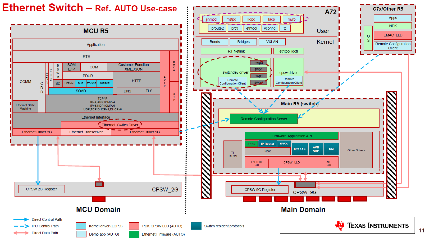

Currently, our Linux data on A72 is sent to the MCU Domain network interface.
The RJ45 connector as shown below.
This situation is puzzling me.
Referring to the figure below, I think the Linux data on A72 will only come in and out from CPSW 9G.
Unless the Ethernet Driver 9G in the mcu domain will collect the CPSW 9G data, and then pass the data to the Ethernet Driver 2G to send it out.
Another possible situation is that the RJ45 connector above is currently set to connect to CPSW 9G.
