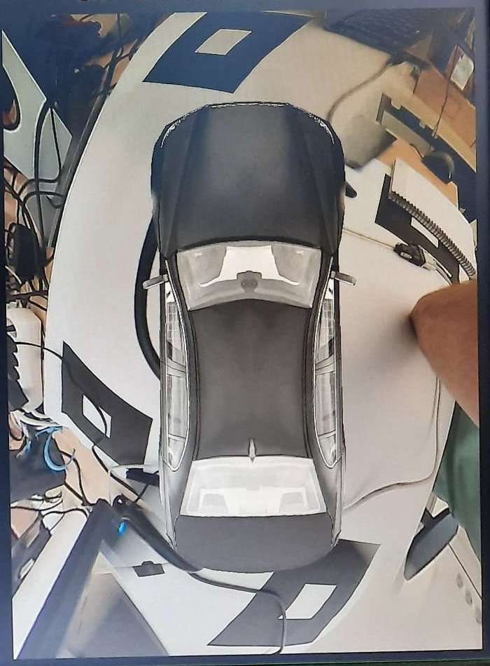

    Additionally, we noticed that 0 viewpoint LUT is not correctly generated when we change the number of points from default 30 to 25 (see attached image). Do you know if there is some limitations imposed by the 3dvis tool when number of points is changes?

    One additional observation. After some experimenting, we noticed that above behavior is not actually related to the number of points but rather to the total number of views. If we exceed the total number of 170, the top view is not correct, however, when the total number of views less than 170 (e.g., when we set 6 virtual views with 25 points) the top view is rendered correctly.

    The second problem is viewpoint 0 is corrupted, it seems like the blend seam is not generated correctly. Can you completely cover one the camera and share the pic?
    As an experiment, can the viewpoint 0 start from different view point?

    Yes, everything looks correct when the SRV starts from the viewpoint 0 starts from different virtual camera view. Only top view seems to be corrupted.

    One correction, the view point 0 is affected regardless of the virtual camera position when total number of points is 200.

    On view point 0 being corrupted : Based on the pictures, the seam angle seems fine. As you suspect that no of view points > 170 causes view point 0 to be corrupted. Can I request you to do the following?
    Suspecting logic to split and write the LUT’s could be the source
