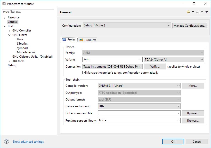

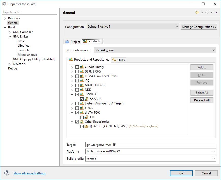

  • Stephen --
      My immediate goal is to get familiar with board, to understand how things are working, and to write some simple code in order to learn. I am able to run bare-metal examples using device drivers separately, and I am able to run BIOS examples separately. At this moment, I do not understand how one is supposed to join those together.
      In section 9.9, SDK Manual refers to "RTOS Template Application", which apparently does exactly what I need. It is supposed to reside in
    <Processor_sdk_rtos_<platform>_<version>/demos/rtos_template_app/<soc_name>/<evm_name>/<core_name>
      but this version of SDK does not have such directory either. Directories present under "demos" are "multicore-streaming" and "eve_audio".
      I took an example "Task Mutex" BIOS code from resource explorer and it runs OK in semi-hosted mode on A15 via JTAG. I am trying to add stdio over UART capabilities to it (again, the only specific goal here is to get something trivial working), so I added Board_init(BOARD_INIT_UART_STDIO) call at the beginning. I added all PDK libraries to the project necessary to compile. Now, BIOS throws exception in Board_init() call as follows:
    Hello World!
     0x0000bb80  R8  = 0x00000000
    R1 = 0x600001df  R9  = 0xffffffff
    R2 = 0x4ae06000  R10 = 0x00000000
    R3 = 0x8001dcf0  R11 = 0x8002b10c
    R4 = 0x0000008c  R12 = 0x8002b110
    R5 = 0x8001d28c  SP(R13) = 0x8002b0f8
    R6 = 0x00000000  LR(R14) = 0x800152c0
    R7 = 0x8002b150  PC(R15) = 0x80014dec
    PSR = 0x200001df
    DFSR = 0x00000206  IFSR = 0x00000000
    DFAR = 0x4ae06118  IFAR = 0x00000000
    ti.sysbios.family.arm.exc.Exception: line 205: E_dataAbort: pc = 0x80014dec, lr = 0x800152c0.
    xdc.runtime.Error.raise: terminating execution
    CortexA15_0: Unhandled ADP_Stopped exception 0x20023
      I suppose one has to configure every specific board differently somehow somewhere? Set some pins/registers to some values? Pass board-specific parameters to init? Where and how do I learn how to do that? Sort of lost here.
      W.r.t. end goal: I have working CCS project, in source code, supplied by third party, based on RTOS, which uses third-party libraries to process audio that streams through line-in and outputs it to line-out. Details of processing change based on packets sent over Ethernet. Everything is working, but code is too complex for me to understand/modify at this point. At the end, I need to a) replace control-over-Ethernet with control-over-UART; b) write/modify a driver/interface for 4 (four) AIC31 codecs on second I2C / McASP6 buses; and c) make sure that nothing breaks.
      For now, most of my attempts to modify the code result in either not getting what I want or everything being broken. So we figured out we should do things in small steps for now. Unfortunately, we're having problems even with small steps due to apparently SDK manual being out of sync with actual SDK.
      Thanks.
    Ramani
  • Hi again,
      I took UART example from PDK, and Board_init() fails with the same reason. Below are all related files, logs, and screenshots. Help would be appreciated.
      The board is jacinto6 EVM one (EVM5777), SDK 04.03.00.05, BIOS 6.52.00.12, PDK dra7xx 1.0.10, CCS version 7.4.0.00015. Thanks.
    Ramani

    var soc   = "dra75x"
    var board = "evmDRA75x";
    xdc.print("# !!!  Current soc is [" + soc + "] !!!");
    xdc.print("# !!!  Current board is [" + board + "] !!!");
    /* Load the OSAL package */
    var osType = "tirtos";
    var Osal   = xdc.loadPackage('ti.osal');
    Osal.Settings.osType = osType;
    /*use CSL package */
    var Csl = xdc.loadPackage('ti.csl');
    Csl.Settings.deviceType = soc;
    /* Load the uart package */
    var Uart = xdc.loadPackage('ti.drv.uart');
    Uart.Settings.socType = soc;
    /* Load the I2C package */
    var I2c = xdc.loadPackage('ti.drv.i2c');
    I2c.Settings.socType = soc;
    /* Load the Board package and set the board name */
    var Board = xdc.loadPackage('ti.board');
    Board.Settings.boardName = board;

    **** Build of configuration Debug for project square ****
    "C:\\ti\\ccsv7\\utils\\bin\\gmake" -k -j 4 all -O
    making ../src/sysbios/sysbios.aa15fg ...
    gmake[1]: Nothing to be done for 'all'.
    'Building file: "../main.c"'
    'Invoking: GNU Compiler'
    "C:/ti/gcc-arm-none-eabi-6-2017-q1-update/bin/arm-none-eabi-gcc.exe" -c -mcpu=cortex-a15 -mtune=cortex-a15 -march=armv7-a -marm -mfloat-abi=hard -DTDA2xx -I"C:/Users/DOLBOEBIKI/dswork/square" -I"C:/ti/bios_6_52_00_12/packages/gnu/targets/arm/libs/install-native/arm-none-eabi/include/newlib-nano" -I"C:/ti/gcc-arm-none-eabi-6-2017-q1-update/arm-none-eabi/include" -g -gdwarf-3 -gstrict-dwarf -Wall -MMD -MP -MF"main.d" -MT"main.o" @"configPkg/compiler.opt" -o"main.o" "../main.c"
    ../main.c:1:0: warning: switch -mcpu=cortex-a15 conflicts with -march=armv7-a switch
    'Finished building: "../main.c"'
    gmake[2]: Nothing to be done for 'all'.
    'Building target: "square.out"'
    'Invoking: GNU Linker'
    "C:/ti/gcc-arm-none-eabi-6-2017-q1-update/bin/arm-none-eabi-gcc.exe" -mtune=cortex-a15 -marm -DTDA2xx -g -gdwarf-3 -gstrict-dwarf -Wall -mfloat-abi=hard -Wl,-Map,"square.map" -nostartfiles -static -Wl,--gc-sections -L"C:/ti/bios_6_52_00_12/packages/gnu/targets/arm/libs/install-native/arm-none-eabi/lib/hard" -Wl,--defsym,STACKSIZE=0x10000 -Wl,--defsym,HEAPSIZE=0x400 --specs=nano.specs -o"square.out" "./main.o" -Wl,-T"configPkg/linker.cmd" -Wl,--start-group -lgcc -lm -lrdimon -lc -Wl,--end-group
    'Finished building target: "square.out"'
    **** Build Finished ****

    =============== Project Properties screenshot #1: =========================
    ===================== Project Properties screenshot #2: ==========================
