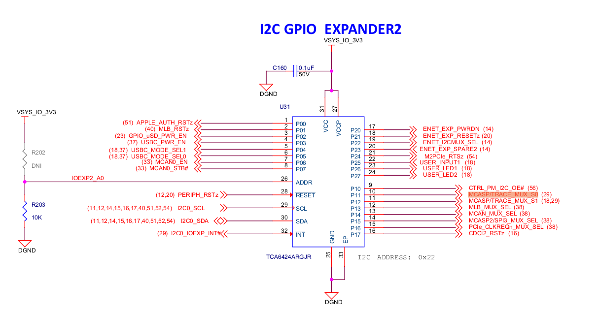

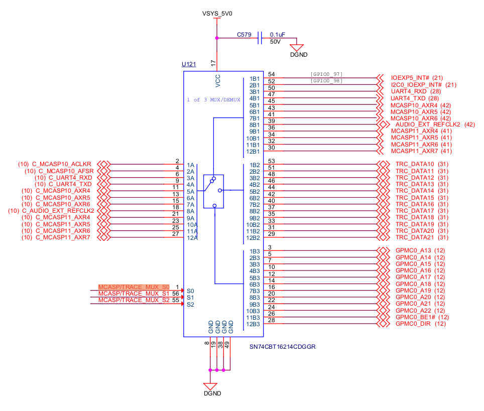

    Correct me if I am wrong.I was looking into the schematics and noticed that there is an extra mux in the path of main_uart4_txd/rxd. The selection pins of that mux can be controlled by an i2c GPIO expander. Since I do not need i2c driver in my system, I am not solely developing a driver for this until I am absolutely sure that this is the reason behind my main_uart4 not working. (see attached pics)
    Can anybody confirm this?
    Usman
  • Hi Usman,
       Your understanding is right. The mux is controlled by an I2c expander. However, the default settings are routed to use UART pins as shown in the diagram. You need not make any changes n I2C expander to get UART4 working.
