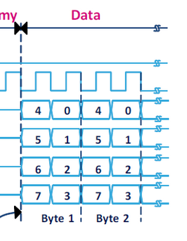

    The picture above depicts 1 command byte, 3 address bytes, 1 mode byte, 1 dummy byte, and 2 data bytes.  The mode bytes are not supported by this QSPI interface.  I am not sure when the D0 becomes an input, but the direction of D0 is automatically controlled by the SPI state machine.

    I have a few comments on the picture you sent.  The timing diagram above uses all four bits as bidirectional.  On the QSPI, only bit D0 is bidirectional.  The rest are input only.  As the TRM says: "The QSPI supports only dual and quad reads. Dual or quad writes are not supported."
    When reading in quad mode, 4-bit nibbles are received into the QSPI_SPI_DATA_REG, and shifted left with each new nibble.  So the first nibble received will be the most significant.  The order of data received in your image appears to be correct.

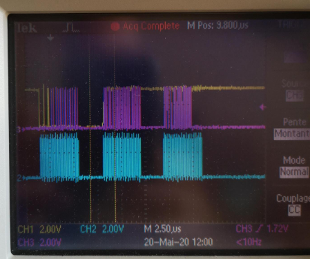

    Please look at the following scope capture:
    Yellow: D0 (MOSI) - The address/Read command is sent - I initiate a WRITE_SINGLE. As the command is 32-bits, I can read the three 32-bits data in a raw.
    Purple: D1 (MISO) - The first packet corresponds to the three 32-bits data following the SINGLE_WRITE command. I don't know why it works as the command send to the QSPI module is a "write" command, but the QSPI_SPI_DATA_REG, QSPI_SPI_DATA_REG_1 and QSPI_SPI_DATA_REG_2 register are updated with the data present on the D1 line following the command.
    The next two packet are 128bits read sequence performed following a  READ_SINGLE command.
    The CS is not represented but it is active during all the transaction.

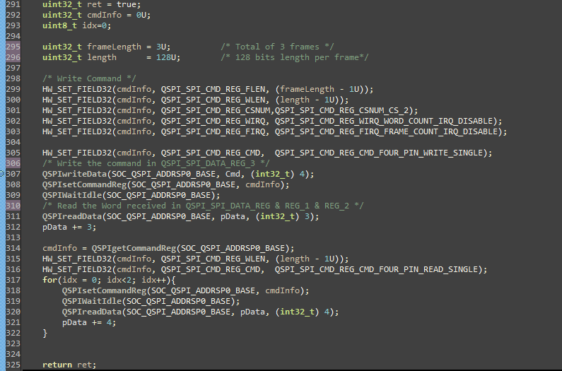

    Here is the code implemented:
    As you see between each frame, there is a delay about 2.5us. As the FPGA is able to transfer 32-bits data continuously without any interuption since the CS stay active, I would like to find a way to perform a read of the whole FPGA memory without these delays.

  • First I want to clarify the terminology being used:
    A frame refers to all of the data transferred during a single transaction.  Everything between the edges of CS during which data is transferred is a frame.  So what you are setting up in lines 295 and 296 is not 3 frames, it is a single frame of 3 words, each word is 128 bits in length.  Each bursts of clock activity you see on the scope is a word.
    So with that said, I don't think that what you've captured on the scope is what I would recommend doing.  The first word has data going out of MOSI, and later data comes in on MISO, all in the same word.  If you tried to expand this to 4bit read, with a bidirectional D0, this will not work.  Instead, you should be separating the write (command and address) portion from the read (data) portion into two separate frames.  As you do the following, keep the FPGA's CS line active, but monitor the CS line output by the QSPI module, as well as MOSI, MISO, and Clk:
    1)The write portion should send only enough clock cycles to get the FPGA ready to send data.  So set frameLength=1, and length=48.  Then trigger the write command as you do in line 308.  No data should come out of the FPGA during this frame.  Please see the TRM, section "24.5.4.1.3 SPI Control Interface" for details on how to load the command and address data into the registers.
    2)Next perform the read portion.  Set frameLength=2 (or 3, or however much data you want to read), and length=128.  Do the reads as you are in your example code.
    Doing this will prevent an issue of data collision on D0, since you are completely separating the write and read portions of the sequence.

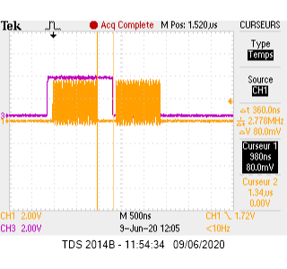

    I modified the order as you suggested and it reduces significantly the time into the gap. It's a reallly good progress. Here is a capture of the result:
    The first packet is the "Read" command sent to the MOSI and the second is the 32b data received on the MISO. In purple, its a GPIO toggled around the function  QSPIwaitIdle();
    That means that the busy bit stay active when the transfert has finished during 360ns.
    Do you have any idea why the bit stay high ?
    Sylvain
  • Sylvain,
    We're looking at the data line in this scope shot, but what is happening on the clock line during this 360ns period?  And CS?  If there is a a similar 360ns gap between clock stopping and CS, then I can't account for that.  But if CS more closely matches the duration of clock activity, that tells me there might be a delay in updating the busy flag from the memory mapped register.  Switching to using interrupts instead of register polling may help in reducing this unnecessary delay in your code.
    -Zack
  • Hi Zack,
    I think this time is coming from the "while" loop. Reading register takes time as well, so I think we need to deal with this.
