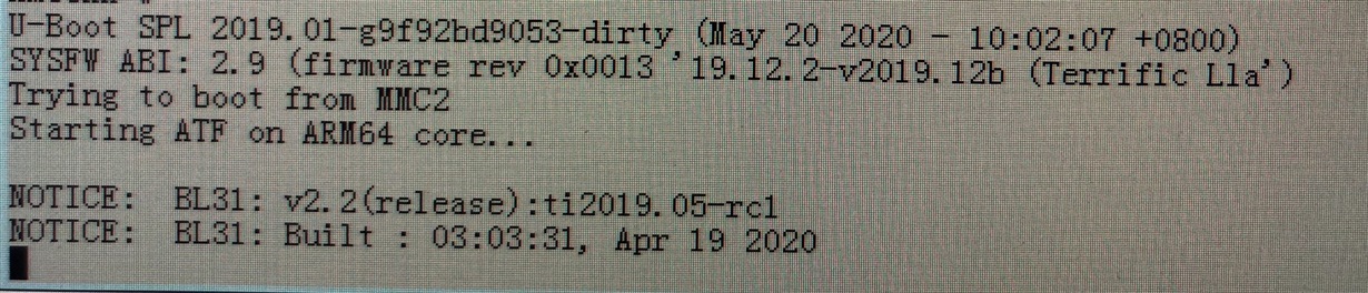

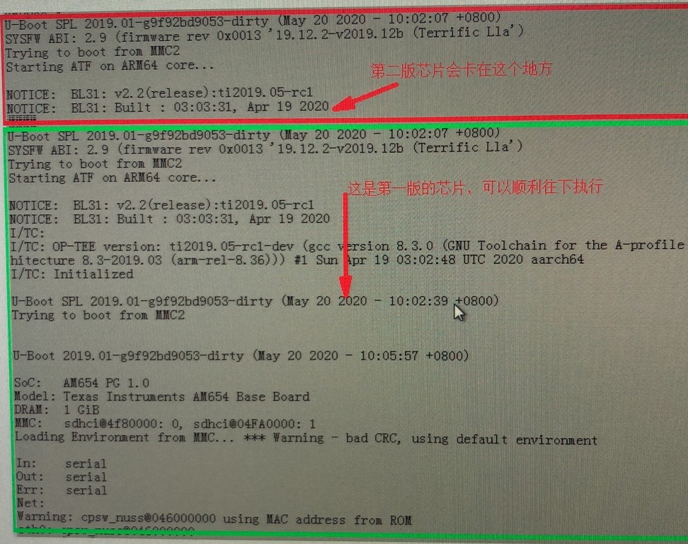

My customer is evaluating PG2.0, even with latest SDK 6.03 UBOOT, pending on SPL as below log:
it is working on old board with PG1.0 device, normal log:
Is there something need to modify in code?
