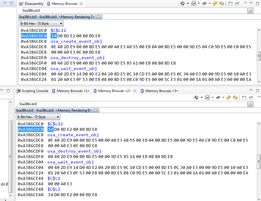

Can you check what is available at 0xa3861f98 and 0xa386cdc0 offsets? it is clearly some corruption at these offsets..

Hi Brijesh,
I checked the address in memory as you suggested i have attaached the snspshot of the same for your reference.
I tired to debug further inside the Semaphore_Pend function and located the exact function where it crashes.
In file sysbios/knl/Semaphore.c Semaphore_pend function in Task_restore(tskKey) function it crashes.
