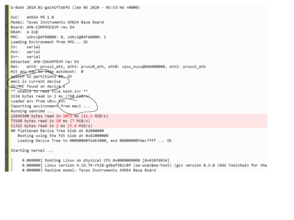

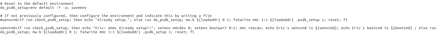

  • Hi Eric,
    So you want uboot to be booted from the same location(SDCard I believe and also uEnv.txt from SDCard), whatever you have configured in boot switch and want kernel and filesystems to come from either eMMC or SDCard ?
    One suggestion is to make uenvcmd as a single line. I see two uenvcmd in uEnv.txt, merge them and have as single line command separated with semi-colon(and also add mmc rescan command as below example I have given)
    Also as I mentioned earlier you can print using echo e.g.
    uenvcmd=if run check_psdk_setup;then echo "   " ................;setenv mmcdev 0;setenv bootpart 0:2; mmc rescan; echo Eric's uenvcmd is ${uenvcmd}; echo Eric's bootcmd is ${bootcmd}

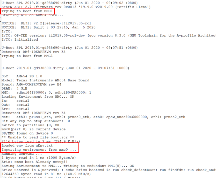

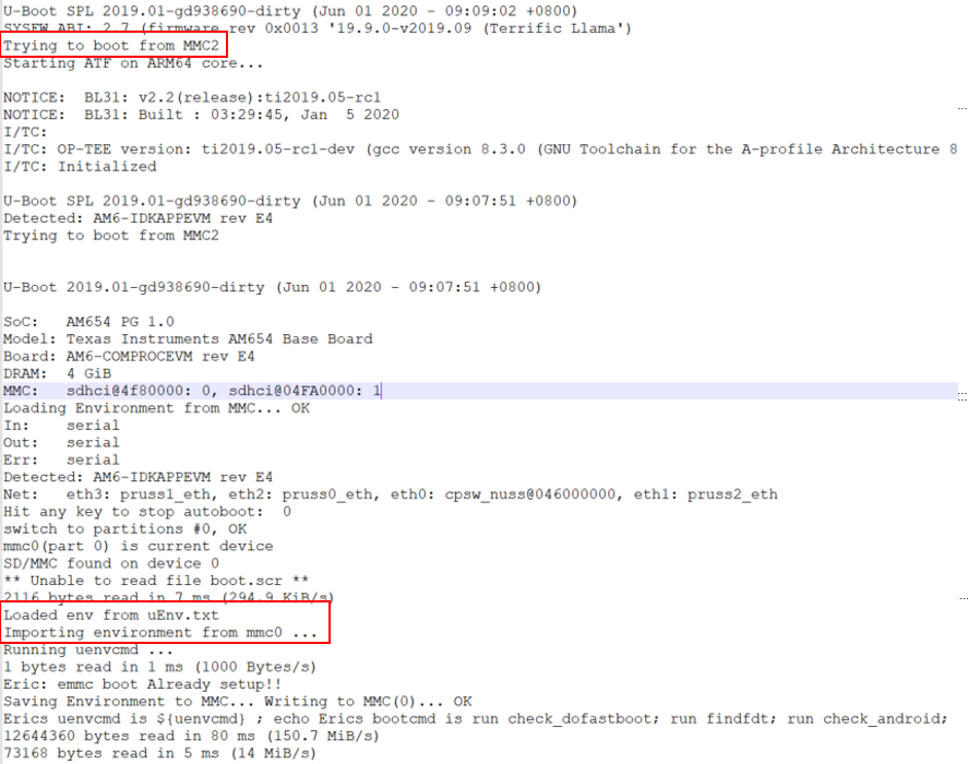

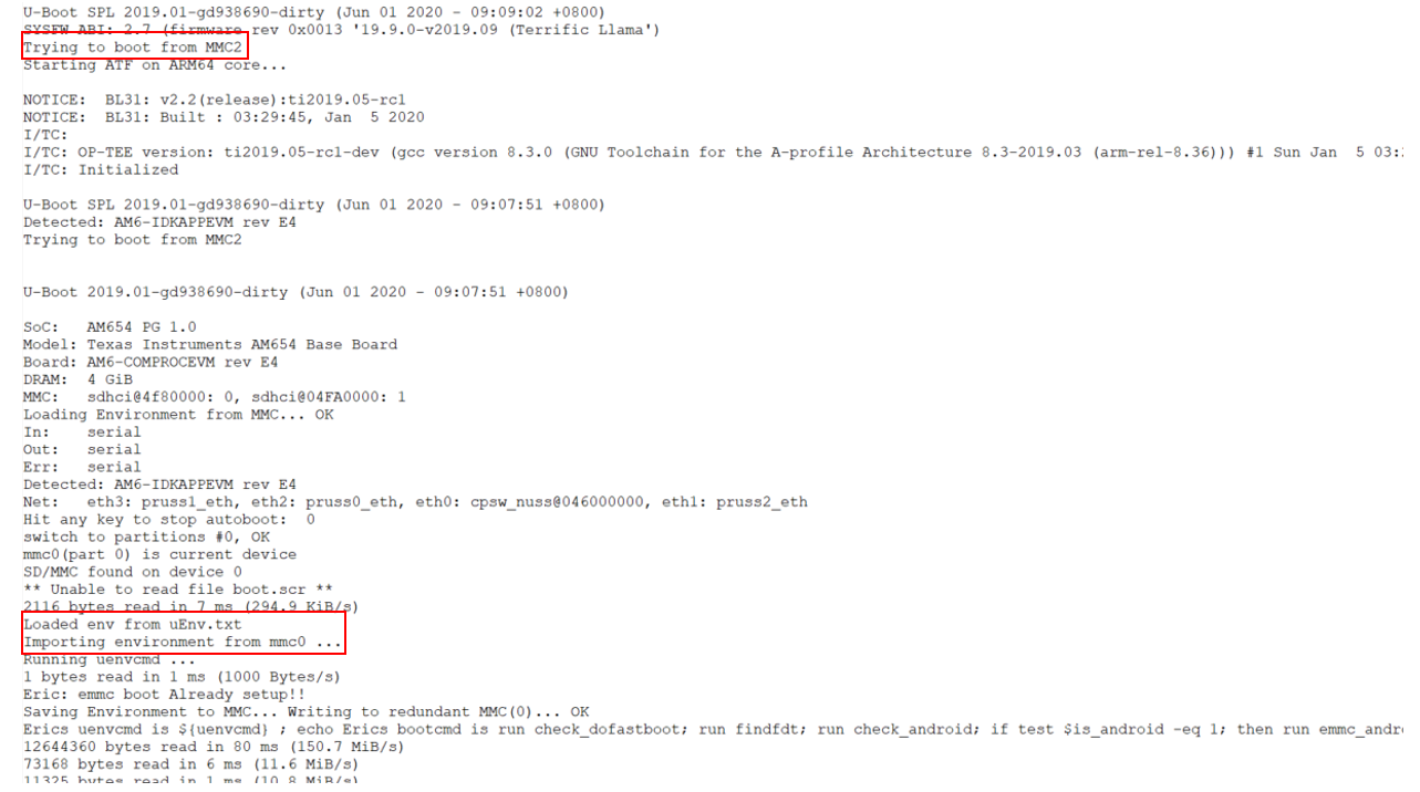

  • Hi Dwarakesh R,
    Yes, no matter where I boot uboot, I want to put two uEnv.txt in both eMMC and SD card.
    In uEnv.txt in eMMC, I want to load filesystem from eMMC.
    In uEnv.txt in SD, I want to load it from SD.
    That's why I want to have 2 uEnv.txt to set different filesystem load location.
    I modified uEnv.txt again for example and put it into my SD card.
    Please help to check if anything mistake.
    However, I cannot see any echo log from console below.
    So, I doubt if uEnv.txt been loaded or not.
    Or it's not work in AM65x EVM board?

    The log is as below.
    Please have a look.

    Looks like you have modified and added prints in only the SDCard(MMC1) uEnv.txt. But looks like eMMC(MMC0) uEnv.txt is picked up with below log
    Hit any key to stop autoboot: 0
    switch to partitions #0, OK
    mmc0(part 0) is current device
    SD/MMC found on device 0
    ** Unable to read file boot.scr **
    1490 bytes read in 7 ms (207 KiB/s)
    Loaded env from uEnv.txt
    Importing environment from mmc0 ...
    Running uenvcmd ...
    1 bytes read in 2 ms (0 Bytes/s)
    Already setup.
    Initial logs that you shared picked up uEnv.txt from SDCard as you can see the same highlighted logs in the below screenshot to be mmc1
    Do you know the difference ? Otherwise you can stop at autoboot and manually set(mmcdev) and check if your script uEnv.txt is loading from mmc1
  • Hi Dwarakesh R.
    Sorry for reply late. I only have EVM board test on Monday.
    Let me clear the question first.
    1.I set the SW to SD boot.
    2.In the uEnv.txt in SD card, I add this.
    And in uEnv.txt in emmc, I add this.
    You can see different debug message between "SD boot" and "emmc boot".
    Then, I boot device and get the log below.
    We can know "Trying to boot from MMC" is due to we set the SW to SD boot. This is no question.
    But, why is log show "Importing environment from mmc0"?
    In my thought, I boot from SD card, and it should load uEnv.txt from SD card, and suppose to see the log
    "Eric: SD boot Already setup!!"
    Please let me know if my question is wrong.
    Thanks.
    Eric

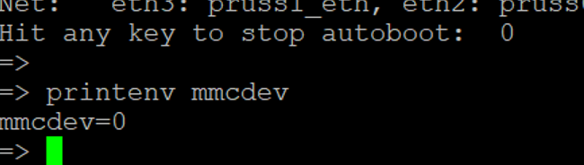

  • Hi Eric,
    The boot switch decides from where to pick the uboot SPL. And before Uenv.txt sets the mmcdev, the same mmcdev from the environment is used for picking he Uenv.txt and it appears to be 0 in even SDCard case. Generally the place where environment saved is also depends on from where the uboot is picked up(either SDCard or eMMC). Can you try the in the above step once to stop the autoboot and set the following
    # setenv mmcdev 1
    # saveenv
    And try from next time if it picks up correctly. Also please check eMMC case too.

  • Hi Dwarakesh R,
    I got two logs as below.
    1. SW choose SD boot
    2. SW to emmc boot
    You can see the boot partition is no question changed accordingly.
    However, the environment to load uEnv.txt is always mmc0 in both case.
    After I set the command you mentioned, and reboot the EVM board, I always got mmcdev is 0 in both SD and emmc case.
    # setenv mmcdev 1
    # saveenv
    I doubt if there is any hard code to prevent uEnv.txt overwrite it.
    Thanks.
    Eric
  • Hi Eric,
    You are right. It is hardcoded here for some reason
    bootcmd=run check_dofastboot; run findfdt; run check_android; if test $is_android -eq 1; then run emmc_android_boot; fi; setenv mmcdev 0; setenv bootpart 0:2; run envboot; run init_${boot}; run boot_rprocs; run get_kern_${boot}; run get_fdt_${boot}; run get_overlay_${boot}; run
    run envboot -> will actually load the uEnv.txt
    You can change it in SDCard boot switch mode as below and give a try:
    # setenv bootcmd 'run check_dofastboot; run findfdt; run check_android; if test $is_android -eq 1; then run emmc_android_boot; fi; setenv mmcdev 1; setenv bootpart 1:2; run envboot; run init_${boot}; run boot_rprocs; run get_kern_${boot}; run get_fdt_${boot}; run get_overlay_${boot}; run'
    # saveenv
    Can you also let me know how have you planned the end customer to change the boot modes ? Do you have this SD/eMMC switch available for the end customer too for them to change and boot ?
