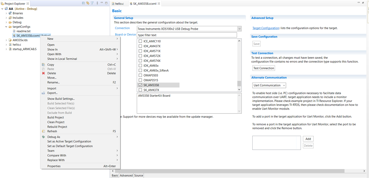

I am trying to run a simple Hello world on TI AM3358 starter kit using CCStudio v10 and did the following:
- Powered board without SDCard and turned it on by holding PowerON switch.
- In CCStudio, created new CCS project (Basic Example - Hello World) with Target - SK_AM3358, Connection - XDS100v2 Debug probe (verified connection).
- Built project successfully.
- Created Debug config under CCS device debug with only CortexA8 selected (in Main tab).
- When I click run, it throws error saying device cannot be connected and it is in reboot loop.
All I am trying to do is to run a simple hello world program. Could you please help me in understanding what is wrong here and how do I fix this. Is it looking for SDcard and how do I erase this part?

  • Hi Avinash,
    In your .ccxml configuration, after you select SK_AM3358 as your board, there should be a "Test Connection" option to the right of "General Setup".
    If you click on that, does the test pass?
    Max

    When I try to debug, I get the following:
  • Do you right click the created .ccxml file and then click "Launch Selected Configuration"?
  • No, because if I right click on my .ccxml I get options shown below, instead I double click it and select SK_AM3358 and press Test Connection.
  • In CCS try going to Window > Show View > Target Configurations and create the target configuration in that interface, rather than in Project Explorer.
    Then try to right click that .ccxml and select "Launch Selected Configuration"
    Moved a step further. Now it shows this and stops:
