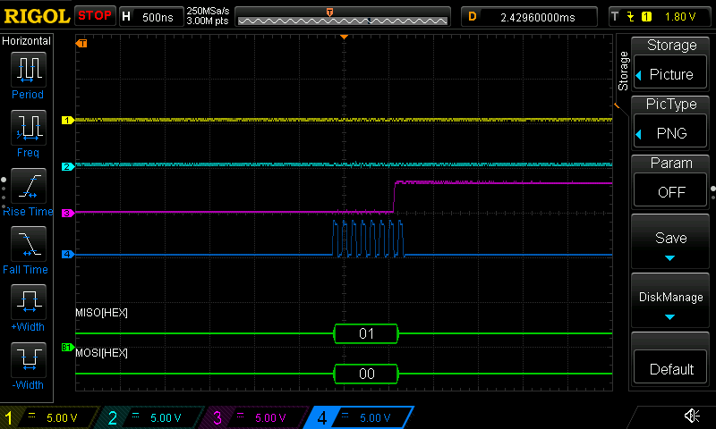

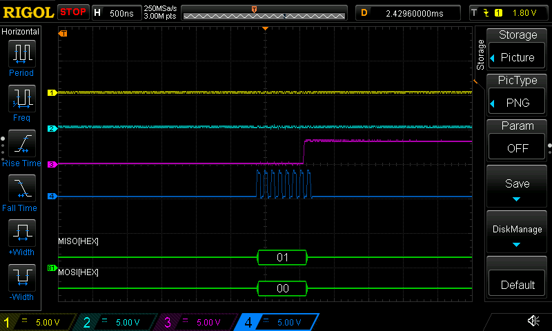

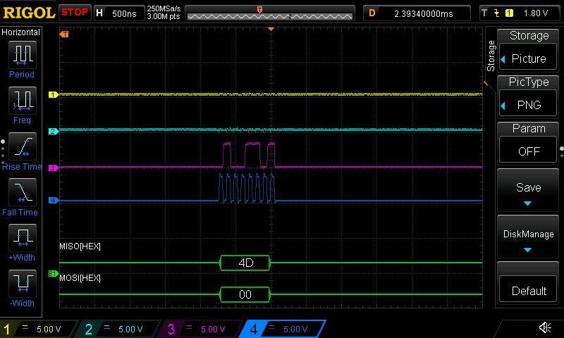

    On second CS, there was another flash. But I removed it, to be sure that im talking to only one device. So, CS1 is connected to S25FL128S, and CS2 is not connected to any device.

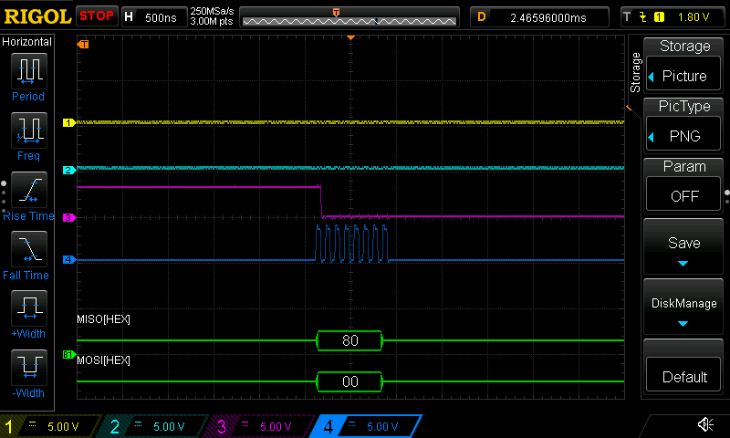

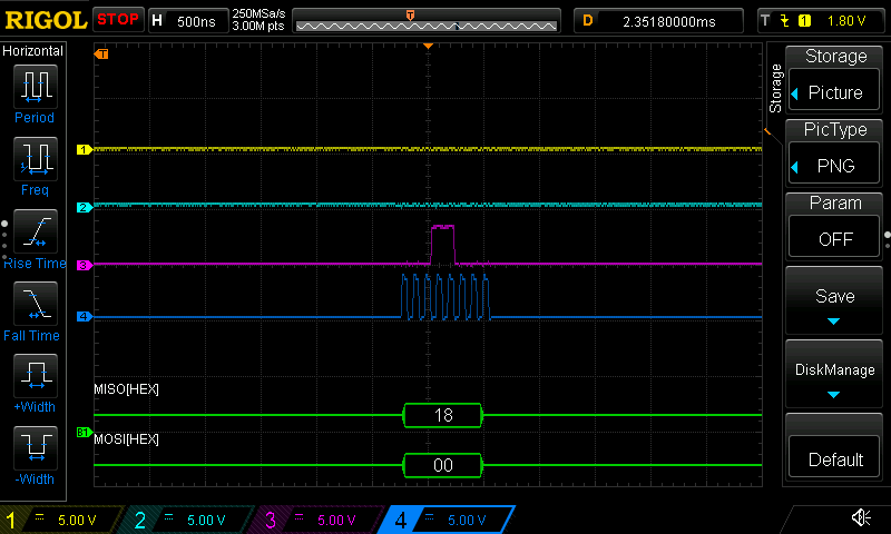

    I have attached Oscilloscope, below I put screenshots of probing flash by kernel, during kernel startup.
    What is interesting from my point of view is that it looks like there is perfect communication between CPU and FLASH,
    1. Master sends RDID 9Fh
    2. Flash response with values exactly as in drivers/mtd/spi_nor/spi_nor.c:
    { "s25fl128s1", INFO6(0x012018, 0x4d0180, 64 * 1024, 256, SPI_NOR_DUAL_READ | SPI_NOR_QUAD_READ | USE_CLSR) },
    on the bottom I paste also full dmesg.

    1. Just to understand, what was the change in kernel dt that made FF FF FF to 00 00 00 ? Is it removing cs-gpios ?
    2. SPI Mode seems to be 0 CPOL=0 CPHA=0. I believe would be seeing similar signals in uboot.
    Just to confirm, in the scope you see chip select to go low for all the transactions and once transaction is complete, it goes high ?
    Just to confirm:
    Yellow = chip select
    Blue/Cyan = MOSI
    Dark Blue = clock
    Purple = MISO
    I am checking the logs and dts you have shared and will revert back
  • Hello
    Thank you for your support.
    1. It looks like the change was due to removing cs-gpios, however it I don't understand why.

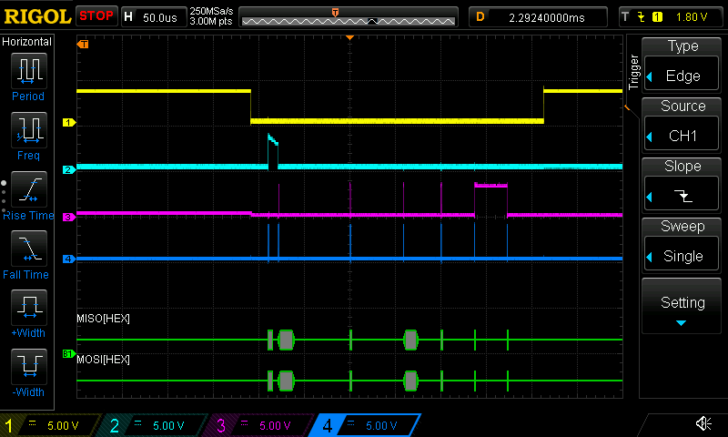

    2. I will do same screenshots from u-boot sf probe, I put them below.
    You have recognised you have correctly. CS stays low for whole probe.
    During kernel startup, before the screenshots I've attached to previous post, there is also some period of CS low, but during this period there is no clock at all, so I omitted it.
