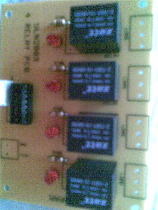

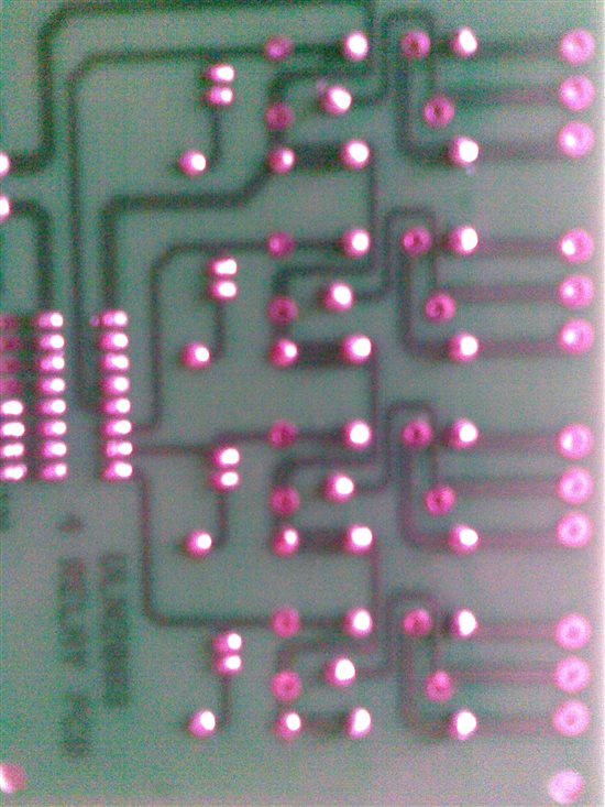

  • sir, this is my pcb board to which now i need to connect a truck , which, according to my input gesture it should move in different directions.here for each relay i should connect vcc,gnd and load....but there are 3 holes so to which hole i should connect vcc,gnd,load...can you please help me....it is spst relay.. sir, i have even attached the back side of board...
  • Hi Swetha,
    I have doubt on this. So I think I would not be able to answer this. You can post a new post so that any other engineer can help you on this who have worked on it.
    Ankit Agrawal
