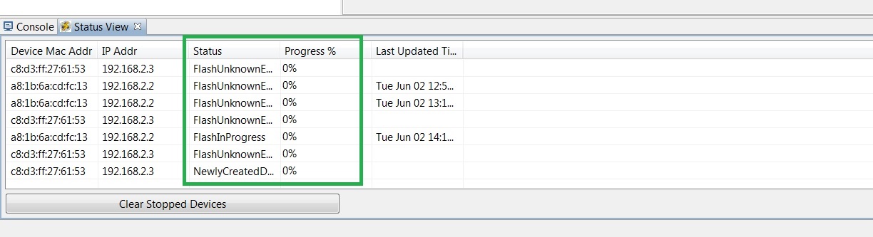

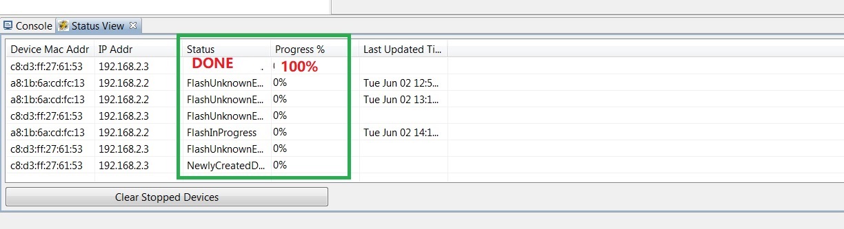

    And I also have another question about this old version. do you know how to control the status of board programming. please see below picture:
    I want to show the some programming status, for example "done" and "Fail" in the status column. but I don't know how to do this.
    Johnny

  • Hi Johnny,
    what exactly are you trying to do? You first mention to control the board programming, and then talk about the status. If it is about the status, is what is already visible in the "Status" column not sufficient? I've not tried using this older version of Uniflash myself, but it may also be possible to monitor the serial console of the device being programmed for output to determine the exact status of the programming process - which could also be done in an automated way.
    Regards, Andreas
  • Hi Andreas,
    I'm sorry to confuse you.
    I want to report the status of the board programming to the Uniflash(PC).
    for example when the we complete the mainboard program, we send out a command from board( I don't know whether TI has this command). and Uniflash show the "done"  status.
  • Hi Johnny,
    I talked with somebody in our team that has some experience with that older Uniflash solution and there is essentially a way to pass status information from the target to Uniflash by way of tftp requests issued through U-Boot (with no actual file transfers happening, tftp is just used to indicate status to the host/Uniflash). I'm just going to pass along the information I got in the hope that will provide you with a starting point to further customize your status messages...
    Attached debrick.txt file that was used to flash the SPI flash on the AM335x EVM. The communication protocol between the target and Uniflash is defined by the section called “# Define System status messages of flashing  <DO NOT MODIFY>”. While this is a U-Boot script, the protocol is really based upon the tftp commands within the script. So, if you want to indicated Programming Complete to Uniflash, you would request a file from the target to the host called “TargetProgrammingComplete”. Uniflash uses this request (the file doesn’t exist on the server in Uniflash) to know that the programming for that board has completed and updates the status bar.
    Regards, Andreas
