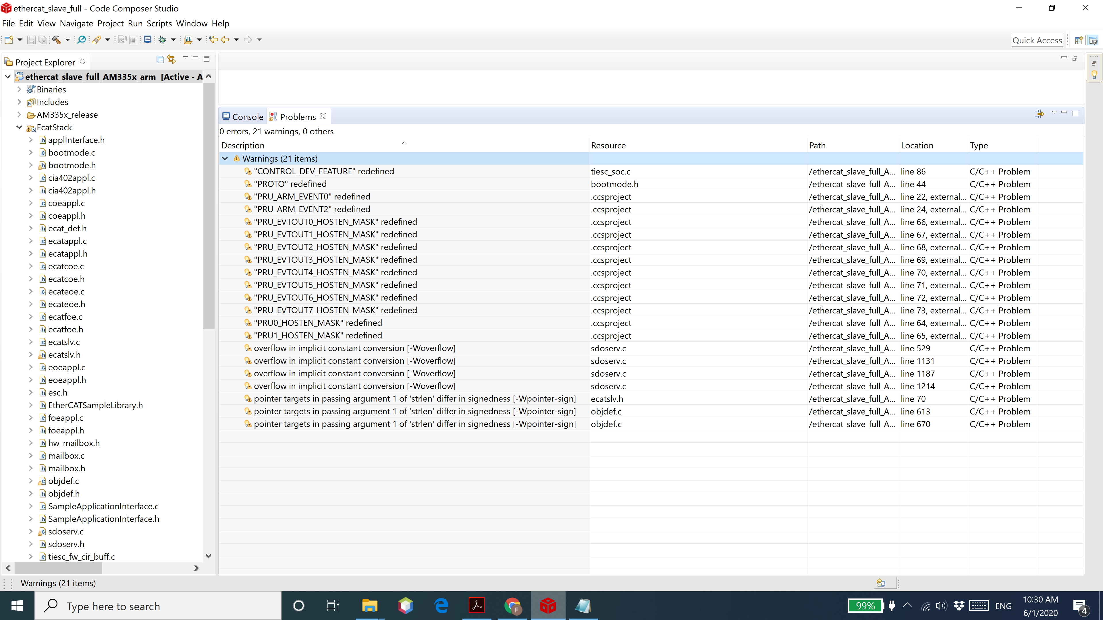

I have been able to compile the EtherCAT SSC version 5.12 which I have downloaded from ETG with zero errors, but many warnings. Before starting to test the software with Beckhoff TwinCat, I would like to ensure that the warnings are not significant and are not going to impact the tests in a negative manner.
The Target configuration is for AM335x ICE V2.
I get NO ERRORS but 21 Warnings after compilation is finished. The code is also build successfully. Before testing, I would like to know if I can manually interfere with the code generation process and eliminate the warnings. Also I hope to get some feedback about which Warnings are significant and should be dealt with.
I have also provided a word document showing a picture of the Problems as seen in CCS Problems page.
14 of the warnings are about some Macro being redefined. I have enclosed here a sample message from the compiler for

Many of the next set of warnings are related to type mismatch and they occur only in compiling sdoserv.c file.
These are the warnings that I am most concerned about. See for yourself:

I don't understand what these -Woverflows refer to. I have not had a chance to investigate what ~SDOHEADER_COMMANDMASK really means. Perhaps you can help.
And this group is mostly about type mismatch but seems like a minor problem:

  • Hi Farrokh,
    This has been tracked in internal JIRA, will be taken care of in next maintenance release. These warnings should have no impact to the EtherCAT functionality.
    Garrett
