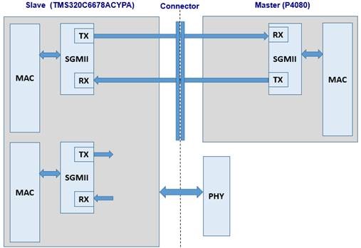

We are planning to use SGMII sections of “TMS320C6678ACYPA” DSP as slave.
We request your suggestion for connection guidelines & layout importance for below configuration.

Shiyam,
The SGMII port supports both MAC-to-MAC and MAC-to-PHY. The configuration will be different for each. Details are discussed in section 2.4 "Serial Gigabit Media Independent Interface (SGMII) Architecture" in the KeyStone Architecture Gigabit Ethernet (GbE) Switch Subsystem User's Guide (SPRUGV9D).
Details about the routing are documented in the SerDes Implementation Guide for KeyStone I Devices Application Report (SPRABC1).
Tom
